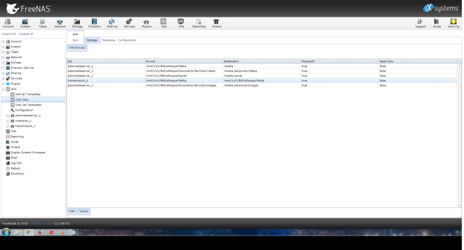

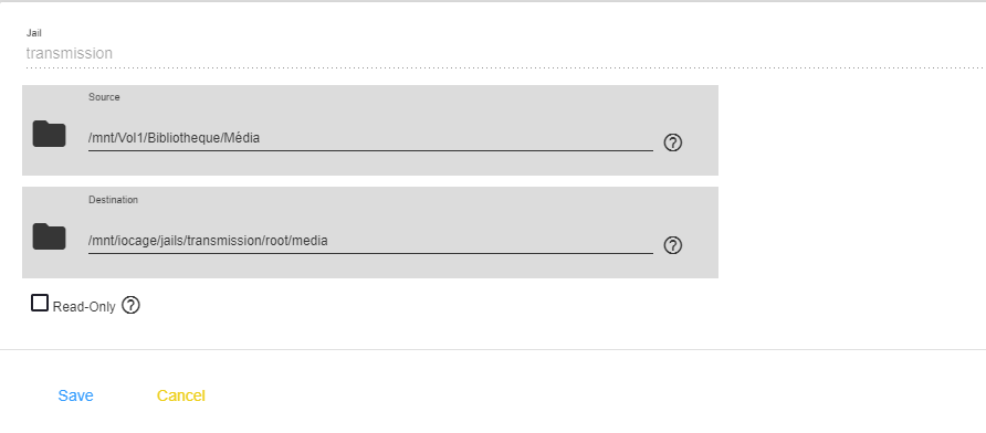

now i can download to the default location in transmission which is not shared anywhere. so i tried to add storage via "add mount point" setting the source as my share which "everyone" can read/write/modify... and my destination as "/mnt/iocage/jails/transmission/root/media/Film" but when i try to download anything it tell me error: permission denied ..... even when in the transmission setting i try to put download to: the source or the destination.

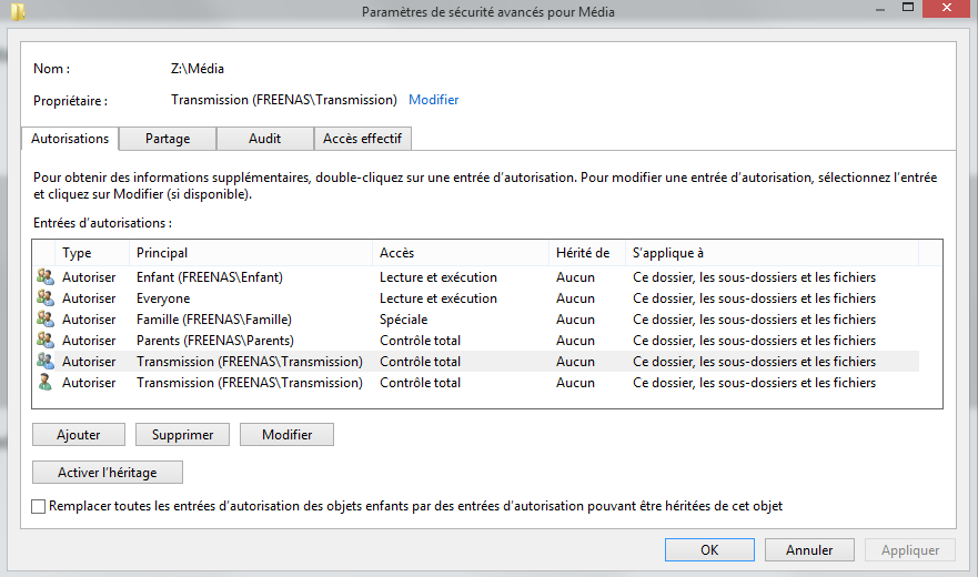

it's really not my day... first, i read the tutorial link above and I had already set my share like they show up but with windows's share

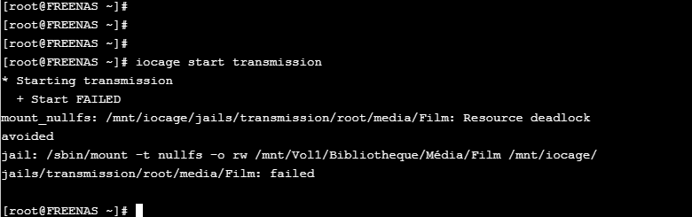

to add to the problem when i was adding mounting point to the transmission jail, i could not stop and the start again transmission.
So, i remove the mounting point and after that i could start transmission.

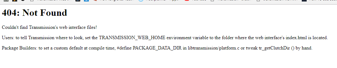

so i continue checking that the user and group that was already created 2 years ago where on the proper 921 GID and UID which it was. i decided to delete my old transmission warden jail to make sure that the old one was not preventing the new iocage jail to have proper id then uninstall pluggin transmission (iocage) and reinstall it.
so i went to the jail's shell
pkg install transmission-web
which worked, but i am at the same place than before
ERROR: permission denied
