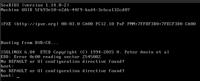

When I use the Legacy BIOS Boot I get:

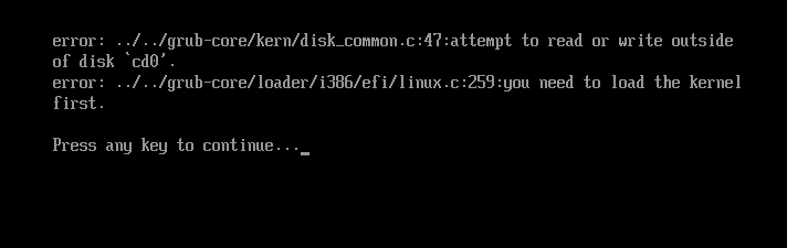

When I use UEFI BIOS Boot I get:

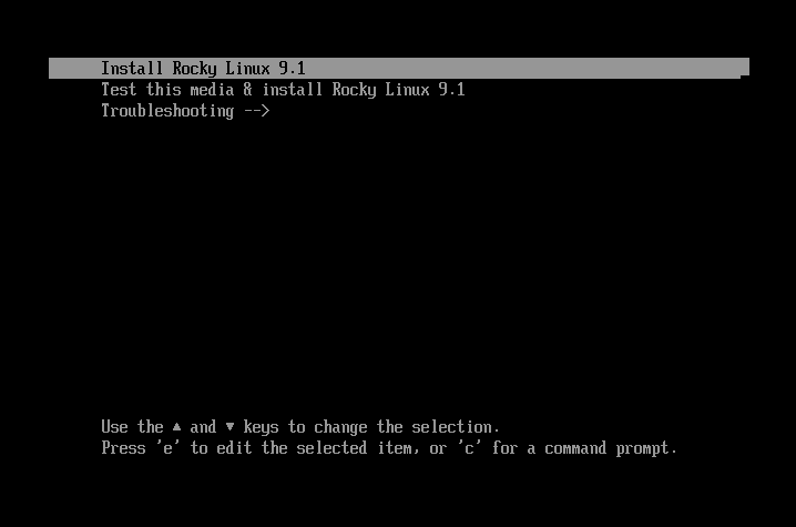

Then when I start the install I get

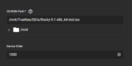

I have the ISO mounted as:

Not sure - but I had real problems setting up a VM, depending on where I put the ISO. Try putting the ISO in different places
jrp
Jan 2, 2023
39
Thanks @NugentS - I created a dataset for ISOs, do you mean create a different dataset?
If both datasets are created the same would not the same problem happen?
NugentS
Apr 16, 2020
2,947
I just remember that if I used on dataset it didn't work, but another location it did. The why's and wherefore's I didn't go into. It was probably permissions
jrp
Jan 2, 2023
39
Gotcha
A buddy has the same setup but a couple of versions back and works fine in dataset
I will open permissions wide open if not work I'll move to a non dataset directory and let you know
jrp
Jan 2, 2023
39
Opened the dataset to the world and same thing happened as initially described
copied ISO to /home/admin with no Joy
This makes absolutely no sense
What was the path that you stored the ISO in @NugentS ?
NugentS
Apr 16, 2020
2,947
It was so long ago - but menory says it was just a dataset with an open ACL
jrp
Jan 2, 2023
39
I tried a 777 ACL WORLD ACL and that did not work.
I looked at my friend's config and he was POSIX ACL not Inherited on the ISO dataset world readable
I will give that a try and see if that helps and let you know
Thanks for getting back to me
jrp
Jan 2, 2023
39
Okay now.....
The issue was NOT with TrueScale but with Rocky 9 ISO o_O
Ubuntu 20.04 LTS is installing just fine with NO ACLs configured except what was default in TrueNas Scale for the dataset
If anyone can figure out what is needed to install ROCKY 9 I would like to know especially since it installed fine on my friend's TrueNas Scale AngelFish
