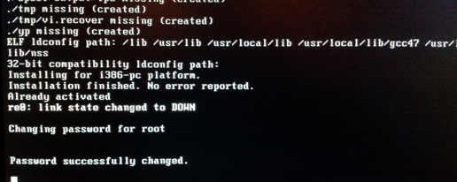

Hi all,
So i try to install it on a system.
At the install i see a strange error gpart: arg0 'ada0': Invalid argument.
Hmm my usb drive is broken and i try 6 other usb drives from 8 to 32 gb
Kingston, datasave, Hama enz enz
All the same error in the beginning off the install.
It looks if the install is OK but NO.
After reboot the system hangs on de USB drive en does nothing at all.
If i remove the USB drive the systen starts agean?
I dont know what to do.
P.s. All the usb drivers work fine is i make them booteble with rufus-1.4.12
on the same system.

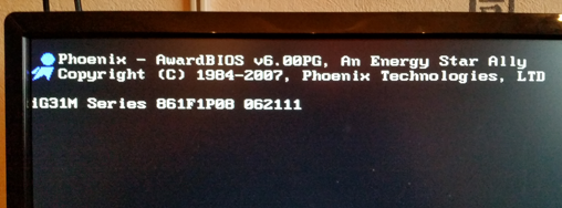

Hmm bios settings ?
If i format the usb drives and make it bootable with rufus-1.4.12 Als drives boot up!
If i make a USB installer it boots up to
Install New CD
This is the drive when is halts my system
krikboh
Sep 21, 2013
209
That board is not appropriate for FreeNAS. Time for better hardware.
