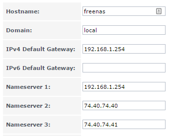

That is what google seemed to imply as well. I tried copying the resolv.conf file after i set up some additional servers like a reddit post suggested but it seems to have the same problem.
My router seems to want to be the primary nameserver so I found out what it was using and put that in the 2nd and 3rd entries
#1 192.168.1.254
#2 74.40.74.40
#3 74.40.74.41
Should i get rid of the router DNS and start with the 74 ones as 1 and 2?
Will this change automatically go through the the jails? Or was the copying of the file what I should do after I make this change?

Don't use your ISP DNS.
Your router should be fine as a nameserver, assuming the router is worth a spit.
Your best bet for a nameserver for your jails is going to be Google. 8.8.8.8 and 8.8.4.4 are Google DNS servers
How do you have your jails configured? DHCP? Or static?
Do you have a proper gateway set for FreeNAS server and is that gateway configured for the jails as well?

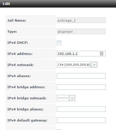

I don't see anything in the Jail GUI that lets me set the name servers there. Would i have to edit a file in the jail to change that?
I have my jails configured however the plugin set it up which appears to be static. When I try to enable IPv4I can't even it won't stay checked. VIMAGE is also checked.
The gateway that is set up for FreeNAS is the same router that does the DNS.

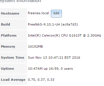

System Information. I installed all updated fairly recently which is my uptime is low.
