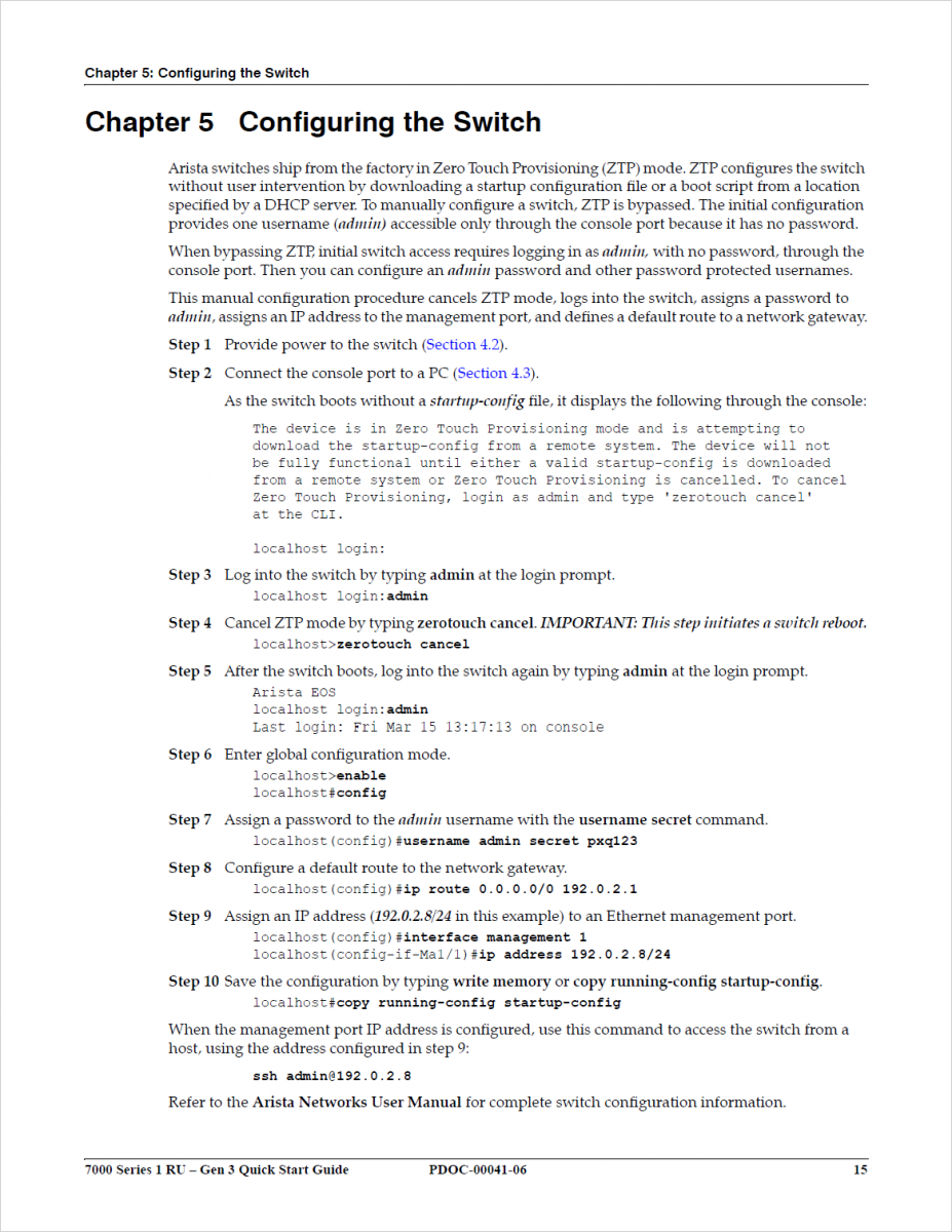

I think the issue is that my switch has to be configured first. It has to be connected to a PC via a serial port which my PC does not have but my FreeNAS server does have. Any idea on how I can configure my switch on my FreeNAS box?
From the instruction manual.
Apr 9, 2015
1,258
You are correct that it will need either a com cable or you will need to set up so it can get an auto config file before you will be able to make it do much.
https://eos.arista.com/ztp-set-up-guide/ can maybe help you set up things so that the switch will allow you to access the management port via ethernet or get it configured. Otherwise for right now it's basically a brick.
