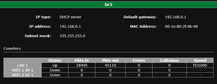

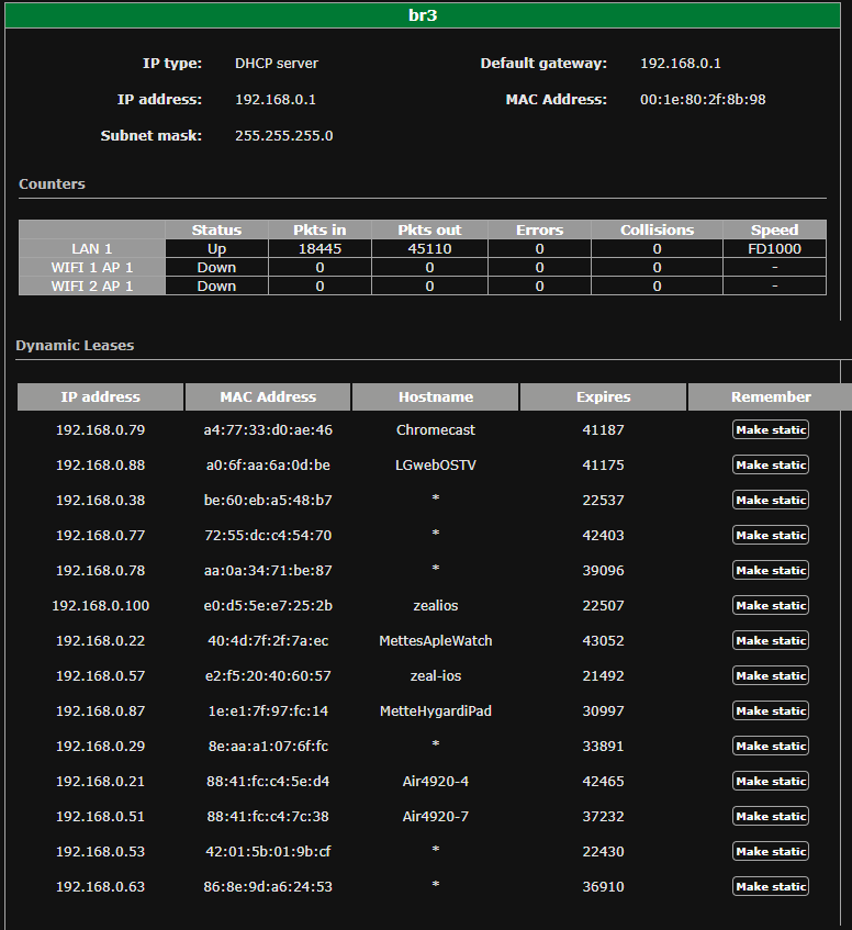

Then, how is your router configured?
zealios
Dec 5, 2021
28
Im not exactly sure what you mean, but hopefully this helps :)

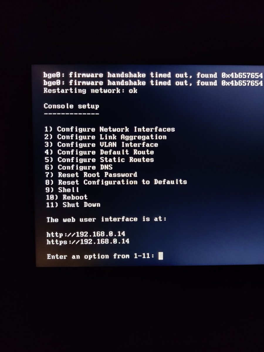

You have two interfaces according to the pictures. Sure you have the right one connected? Or the right one configured?

We're still trying to figure out where the 10.212.126.0/24 network is coming from.
Patrick M. Hausen
Nov 25, 2013
7,776
Is that what you meant?
No. Your Truenas has got two interfaces - bge0 and bge1. Try configuring bge0 instead of bge1 with your IP address.

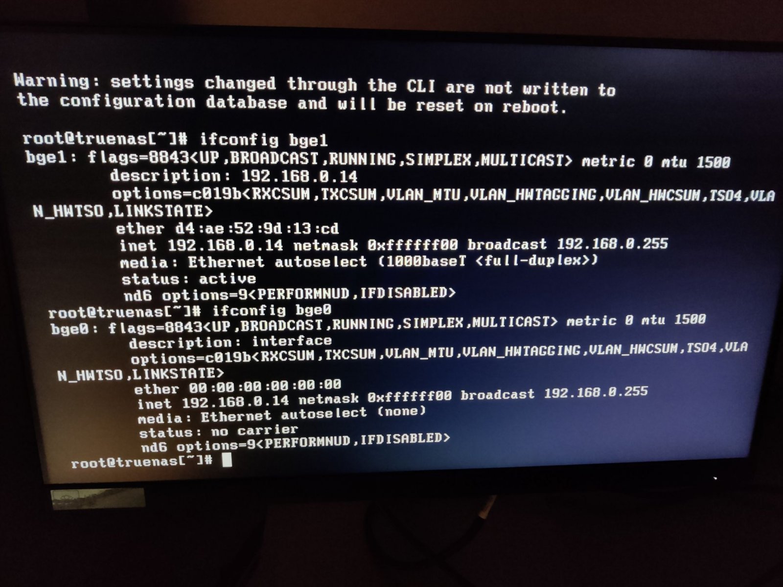

No, you misunderstand. I suspect you're plugged into bge0, and not bge1. Run ifconfig bge1, and see if it has link, and is enabled.
zealios
Dec 5, 2021
28
I tried running both ifconfig bge1 and ifconfig bge0
Patrick M. Hausen
Nov 25, 2013
7,776

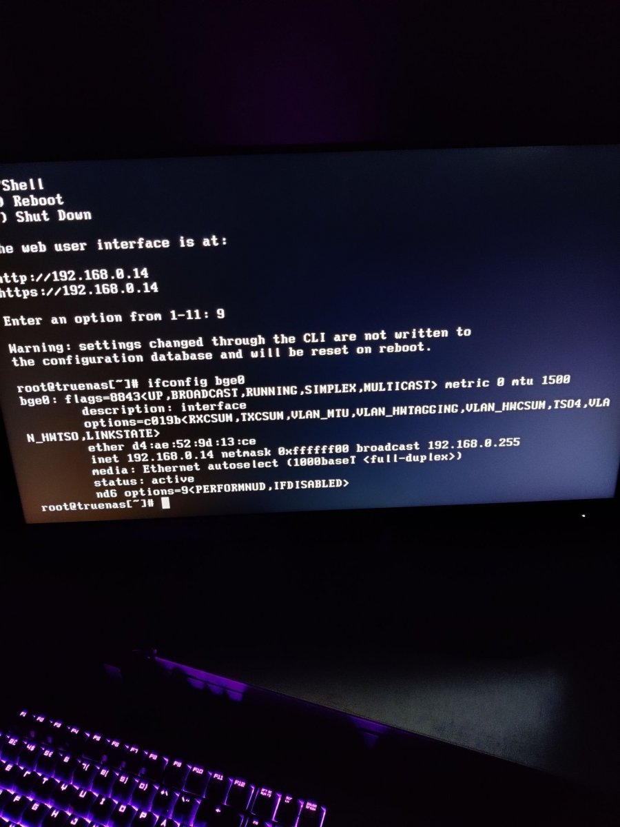

You need to clear the configuration on bge0. Or clear on bge1 and switch the cable to the other port. You cannot have the same IP address on two ports.
zealios
Dec 5, 2021
28
I tried switching the cable, and deleting the interface of bge1. Still no connection.
Patrick M. Hausen
Nov 25, 2013
7,776
ifconfig after you did that?
Samuel Tai
Apr 24, 2020
5,399
If you have the firmware download error on bge0, that's likely bad. Run everything on bge1.
