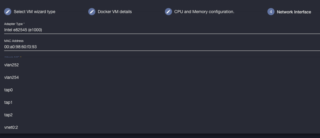

Can someone using the new interface check if this happens also in it? (I'm not sure if it's just graphical issue)
I can see physical interface, taps, vnets, and VLANs in the 11.2 new UI for Docker VM Creation.

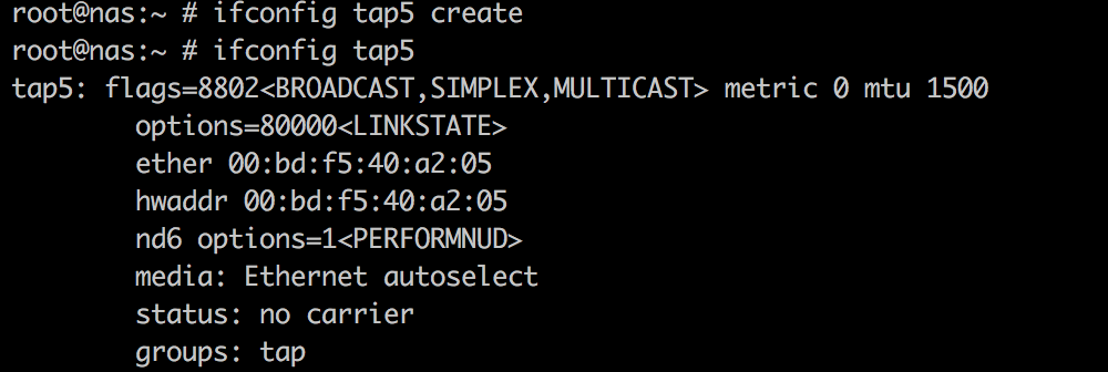

Create tap5 interface:

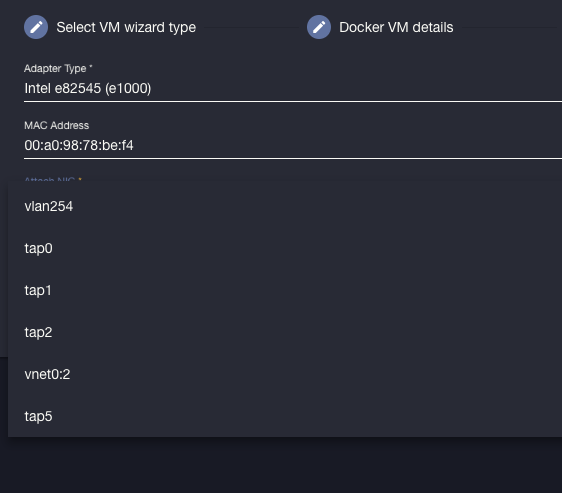

Make Docker VM and look for tap5:
