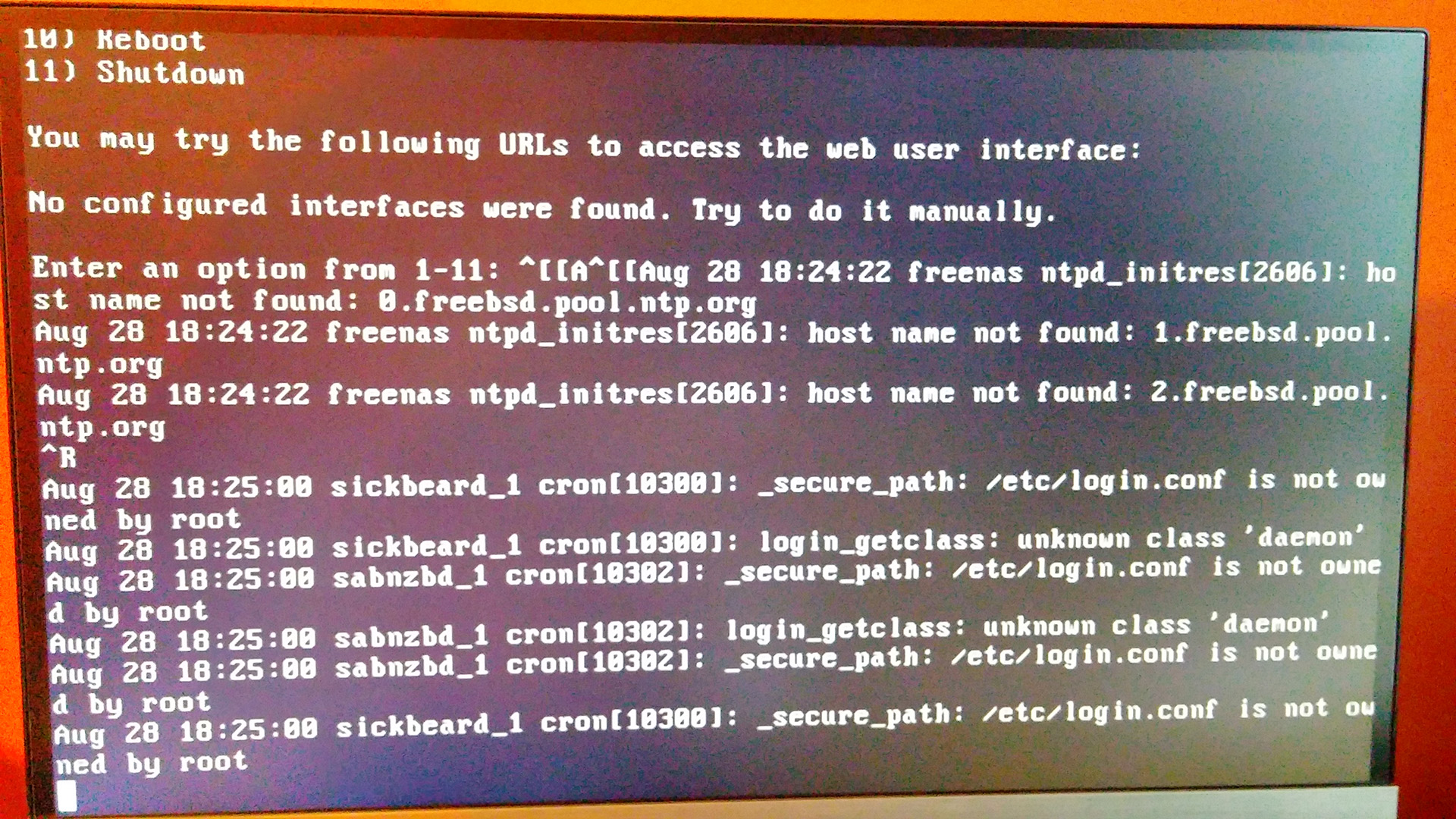

I'm having some difficulty accessing the Web GUI for my Freenas Setup.
It's been working fine for the last month since I built it up until today.
I was restarted it multiple times and even has a static IP setup for both NIC's on my router but now its not even showing up in my router devices. I'm thinking NIC's could have went out, but the IPMI shows them as active and working.
AsRock c2750
8GB Corsair ECC RAM
When I do restart and hook it up to monitor and keyboard all i get on the screen are these messages over and over such as the ones below plus no URL. It says "no configured interfaces were found. Try to do it manually."
sabnzbd_1 cron[10918]: login_getclass: unkonwn class 'daemon'
same thing for sickbeard and transmission.
saying something about /etc/login.conf is not owned by root for the plugins as well. I really don't want to start over from scratch and I dont have my config backed up.
Can someone please help me. I am a noob.

So I finally had some time tonight to run their tool from a DOS flash drive and it passed. I still find it strange that I still don't see NIC's on my network though. I did take a pic with my phone to show you guys what error I'm getting because I still can't get it to work. Hopefully this helps. It just keeps saying these errors over and over again. If there is a way to backup my config file and start over i'd be more than happy to do that, I just have no clue how or if its even possible at this point. Thanks for the help.
