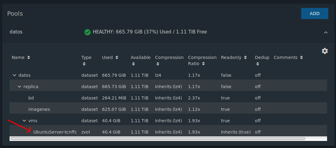

Hi, I have a replicated FreeNas server containing many datasets and one of them is an zvol that is shown on Storage->Pools, but if I go to the console an do an ls -lah I cannot see it, but I can see all the other datasets.
The next image shows the zvol:
But if I go to the console the directory /mnt/datos/vms does not contain anything:

I found the zvol is in /dev/zvol/datos/replica/vms/UbuntuServer-tcnffc, now how can I mount it?. It is the primary disk of an Ubuntu Virtual Machine.
9,700
If it's not a ZFS filesystem, the official position is that you can't. (even if it were, that's not really how you should use a zvol)
Zvols are block storage and as far as the FreeNAS server is concerned, its job is to ensure that those blocks are kept in a consistent state and can be shared/served over iSCSI or direct block access by VMs.
You may be able to use the fuse filesystems pre-installed in FreeNAS, but you won't find help in the docs for that. The best/recommended way to mount the content is over iSCSI or with a VM.
