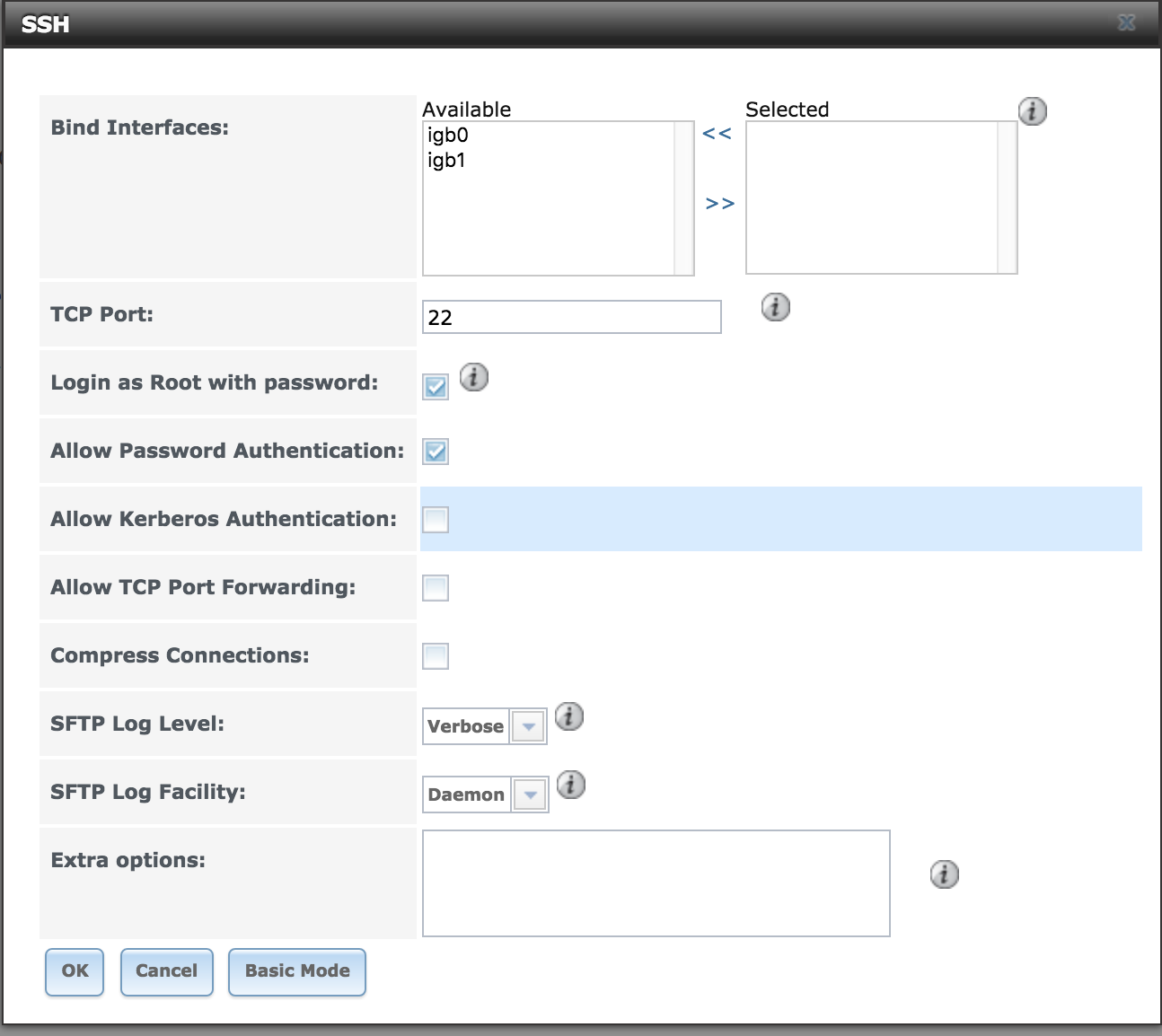

my mini is connected to my att router via Ethernet, I can access the web ui normally. my user is an admin but not root, has a public key and is in the sshd group as well as wheel.
my ssh service settings look as follows
index.php
as best as I can tell my router is not blocking port 22. I am on the same network via wifi. There is no output in the FreeNAS footer console (related to ssh at least)

You don't have any interfaces selected.

edit: omg that attachment might have rang a bell, I have always just clicked the service tab in the left hand menu never the top tab :oops: so I never saw that view that tells if you if its running or not, it is running now, will reboot and see if it still says its running
