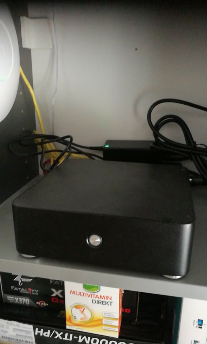

P.s - if anyone was wondering what it looks like :

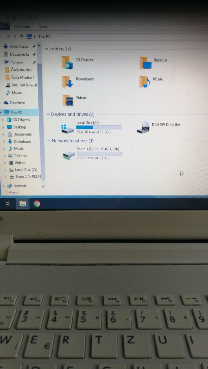

Small update ... its Windows being an @ss all along . I powered up my old laptop ( sadly it did update to the latest WIn 10) , but , the moment SMB went online , i could see the share on the network , and all other PCs. I could also connect to the share , but sadly could not do anything in it .

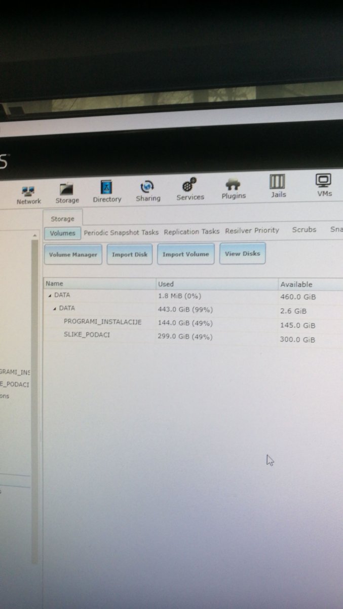

I think the picture says it all :)
Thanks alot for the help .
