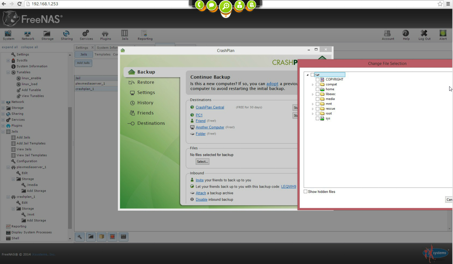

I've got 2 jails going. 1 plex, 1 crashplan. Plex works perfectly.
Crashplan however, I can get the gui on my windows pc to load, but when I browse the files to choose to backup, it shows a typical empty jail folder tree.
The jail storage is as follows:
source: /mnt/Raid1
dest: /mnt
create dir checked
mounted checked
I've tried mounted and un mounted with no luck.
Maybe this is a permissions issue? or maybe I'm just doing something wrong? Please help :)

Expand "mnt" in the crashplan window.

Can you try to expand any of the other folders that have subdirectories and take another screen shot? i.e. the ones with the triangles?

I'm getting this in the console footer:
it shows manage.py middlewareerror: the path could not be mounted /mnt/Raid1: mount failed (64)
mount nullfs: /mnt/Raid1 (/mnt/Raid1) and /mnt/Raid1/jails/crashplan_1/mnt/Raid1 are not distinct paths
I've also tried setting destination as /media and still get the same error.
elementalwindx
Sep 20, 2012
20
Got it figured out. Ended up using mount -t nullfs command directly from the main shell. (not jailed shell either)
Thanks guys.
