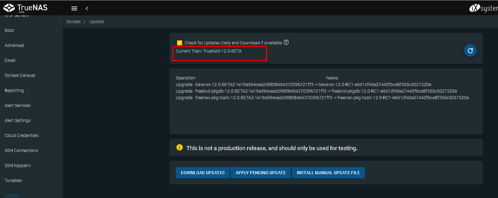

Cannot see any train option
Fred974
Jul 2, 2016
190
I installed TrueNAS when it was first realeased in beta.
I am now wanted to use the release version but I have no option to change the train in system > update
Could anyone please advise?
Do I need to update to latest beta and then to release?

Hi and thank you for your reply.
Here is what I get when I ran the command:
[ENOENT] Invalid train name.

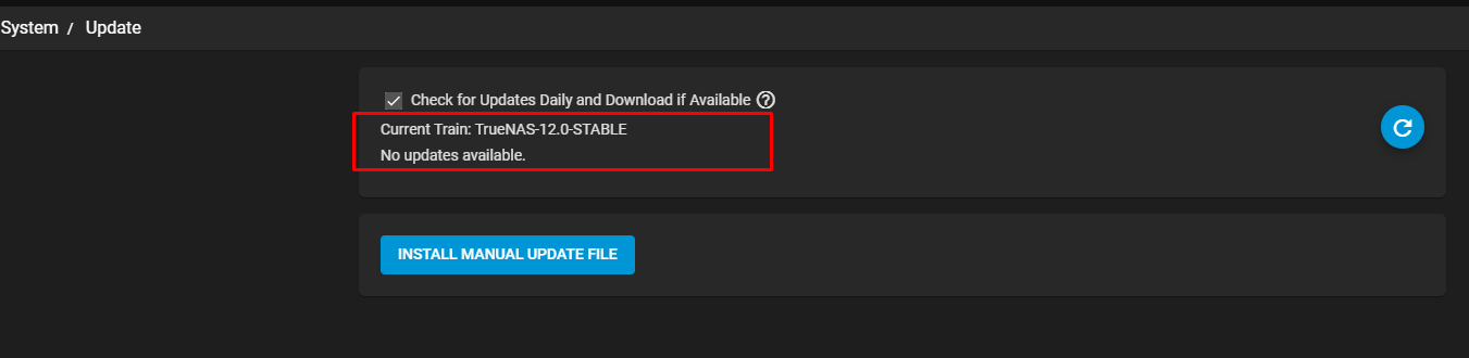

Well on my production I am on TrueNAS-12.0-STABLE and I don't have the option to change train there either
Are suppose to have a dropdown?
9,700
The dropdown appears under some conditions... obviously there are no trains that are valid for you to change to from that version right now.
