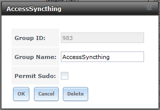

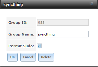

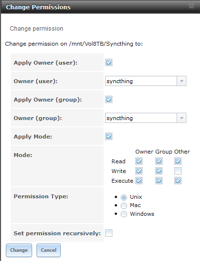

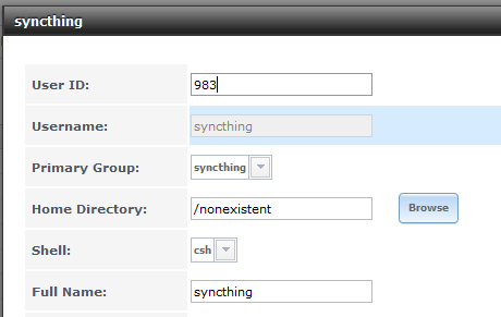

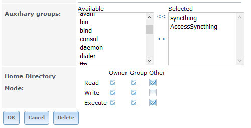

I did what you suggested but I still have the problem. I created a group called AccessSincthing with the same GID as Syncthing. I added the group to my user's auxiliary groups but still have the same issue. please have a look at these screenshots for my configurations so far:
mvcad
Feb 25, 2018
116
Syncthing user:
ST Group
AccessSyncthin GID
Dataset
My User Auxiliary groups:

I did try that but no luck. However I managed to get it working by changing the permission type from Unix to Windows., and now I can modify any file. Just wondering if this has any security implication?
