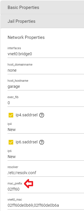

In the jail GUI, this is in the Network Properties pane.
This sets a virtual MAC prefix for the 2 sides of the epairna/b interfaces for the jail (epairna outside the jail, epairnb inside the jail). This has nothing to do with the physical MACs on the interfaces.

This setting above changes the value for the specified jail. To change the default setting for all jails going forward, you can also enter iocage set mac_prefix=02ff60 default at the command line.

i'm running into a similar problem where i get the error message about an invalid mac_prefix. during jail creation, the gui is setting the mac_prefix to ac1f6b. does it matter what i change the prefix to or can it be any random hex number as long as it matches the pattern?
also, i have existing jails that work, but their the mac_prefix set to ac1f6b. should i change the mac_prefix for those jails to match the pattern?

Any random hex string that matches the pattern will work. If you have jails that work, I would leave them alone.
