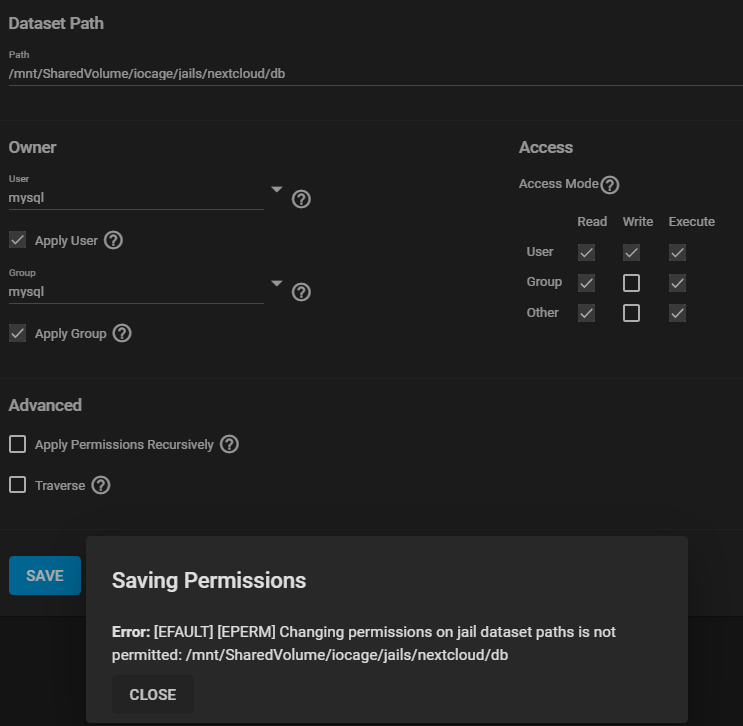

Hello,
I'm following this guide to install Nextcloud but when I get to the part where I need to change the permissions in each dataset, I get this error:

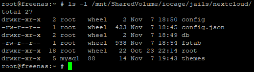

This is the output of the Nextcloud dataset for permissions:
I don't really understand what is the issue, the error is not really descriptive so I don't know where to look or what to change. Any thoughts?

Are you sure the dataset path is correct ?
The jail datasets are usually .../iocage/jails/jailname/root/ then folders.

I tried again but it won't let me change permissions.
Meya
Dec 5, 2018
39
I've been testing trying to change permissions with a temp jail (with no data in it, just plain) and I get the same error. I don't understand what the issue is here.

It's not possible to change permissions for anything in the iocage tree. What you should do is to mount another dataset outside that tree into the jail. You'll be able to change permissions on the external dataset.

That's strange because :
/mnt/vol1/iocage/jails/urbackup/root/var/urbackup in my jail is set to user:891, group:891 (urbackup)
Nothing is mounted in that path ?

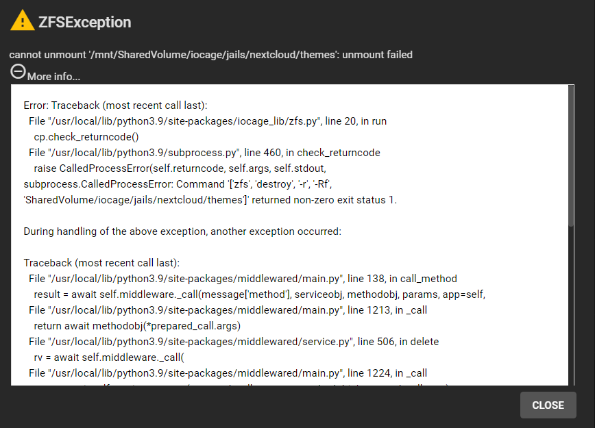

I tried deleting the jail to start fresh and I get this error:
Alecmascot
Mar 18, 2014
1,177
What command did you use ?
Meya
Dec 5, 2018
39
I tried deleting it from the GUI first and then from the command line using
> iocage destroy nextcloud
but got the same result. I'm trying to change permissions because I was following the guide from the link I posted in my OP.
