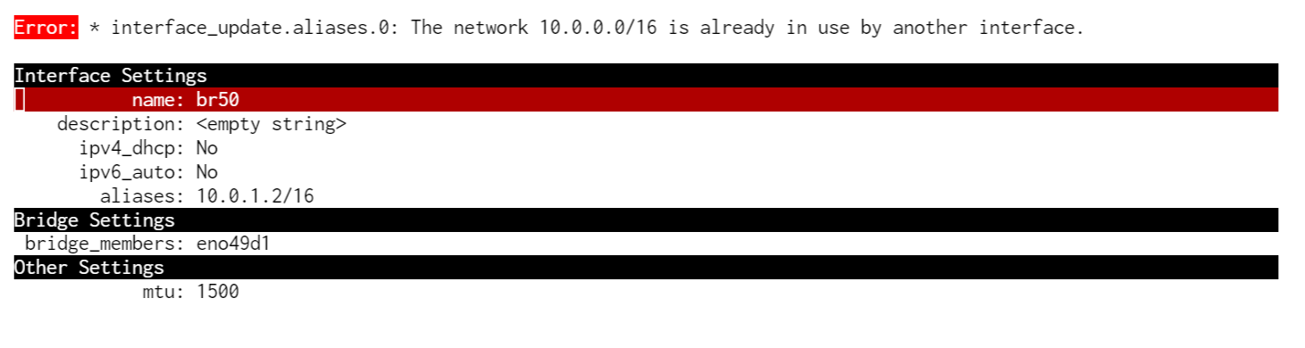

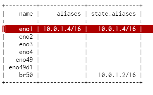

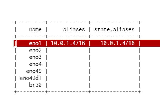

Also, this is what happens in the console:
eno1 is set via alias to 10.0.1.4/16 and br50 is DHCP off and no alias.
If I attempt to set br50 to an alias of 10.0.1.2/16 this is what I get.

If I then just turn on DHCP on br50 it then picks up 10.0.1.2/16 since I forced a static via my DHCP server.
So after testing I discovered this workaround and everything seems to be working fine even though both are on the same subnet.
Does anyone have insight into why double interfaces to the same subnet is bad? I'm quite new to networking as a whole, this is a home lab intended to help me learn. So please, if this is terrible and I shouldn't ever do this I would like to know the reason(s) why and not just that I shouldn't.
It's not "bad". It doesn't work. It violates IP addressing and routing standards. Simple as that. A host is supposed to pick one connected interface for any locally connected network.
You can achieve load balancing and redundancy on layer 2 - that's called LACP and needs support on the other end of the connection, in most cases your switch.
Or you can do it on layer 3 using two different subnets, and something called equal cost multipath routing.
Please read https://www.truenas.com/community/resources/multiple-network-interfaces-on-a-single-subnet.45/
