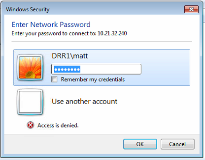

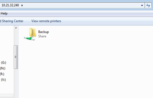

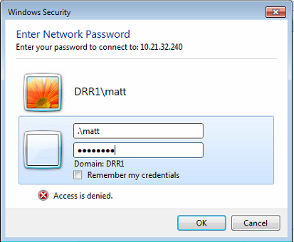

Here is my dilemma. I have an UNRAID server and Freenas server on my network. Both are on the 10.21.32.* subnet. Anything on that subnet, and anything that comes in on VPN are able to authenticate no problem.
I have another subnet on 10.10.50.* Any of the computers on that subnet are able to browse and authenticate no problem on UNRAID. But, when I go to Freenas from those machines, I can browse the shares, but not able to login. I get the Wrong username or password error. I have tried logging in with .\username but still no luck. If I enable guest, they can access the shares fine on Freenas.
All of the machines are Windows 7
No Domain, only WORKGROUP
I am able to ping Freenas from the 10.10.50.0 subnet with no issues
Any guidance from the Freenas gods would be appreciated!!

Thanks for the reply. I only use IP's, as the hostnames do not forward across subnets. The pictures show what the issue is. No matter how I try to login I get access denied. I can see the share no problem, and I can access the unraid server no problem. I am just stuck on Freenas.
