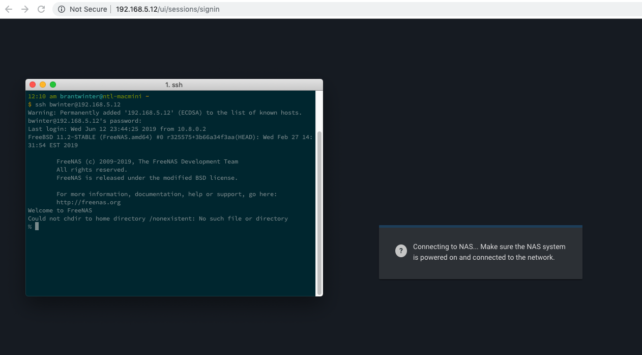

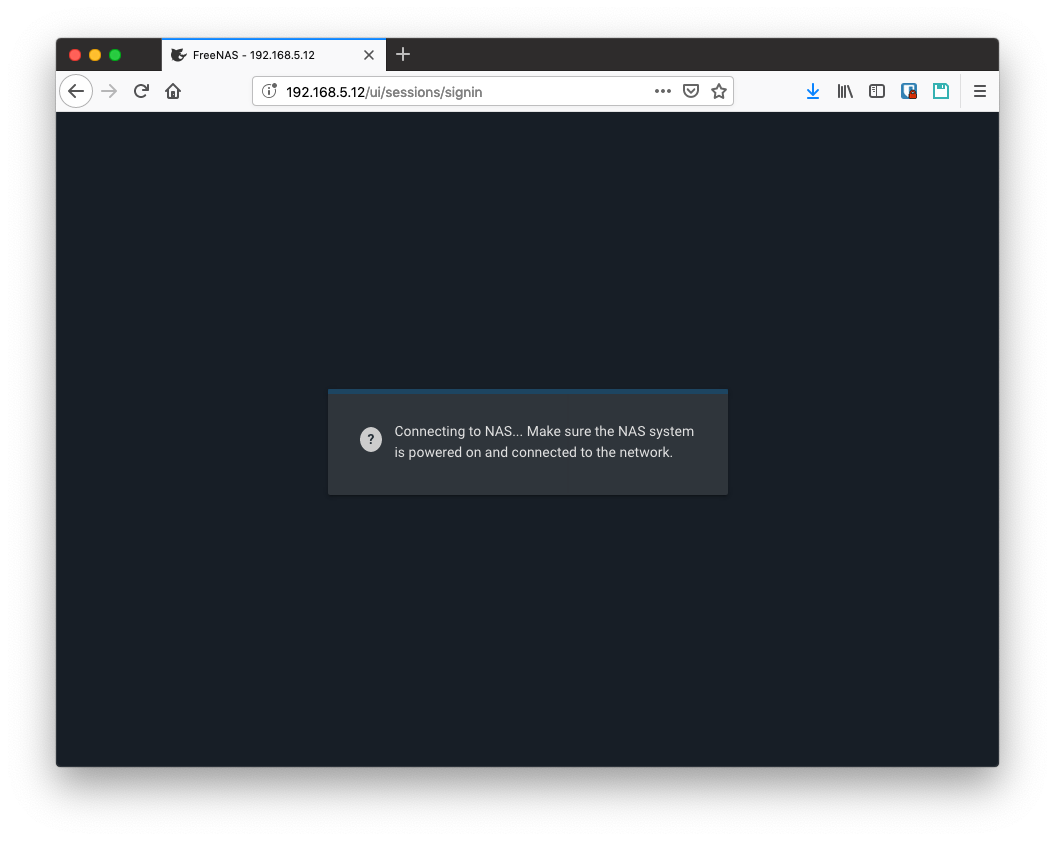

Not sure whats going on but I can SSH to, and connect to SMB shares on a FreeNAS 11.2 box but cannot access the Web UI. I get a message stating:
Connecting to NAS... Make sure the NAS system is powered on and connected to the network.
Obviously if the NAS was not powered on I would not see that message, same if it was not connected to network!

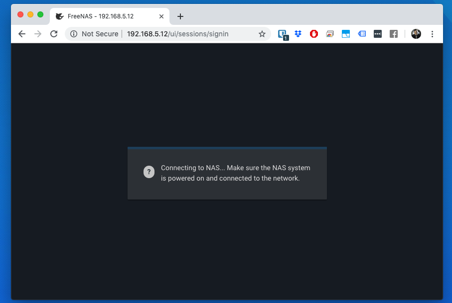

Tried Chrome and Firefox (latest updates), cleared caches, tried incognito mode etc. No plugins other than BitWarden password management and have never had a problem with any of the same browser / installs until now.

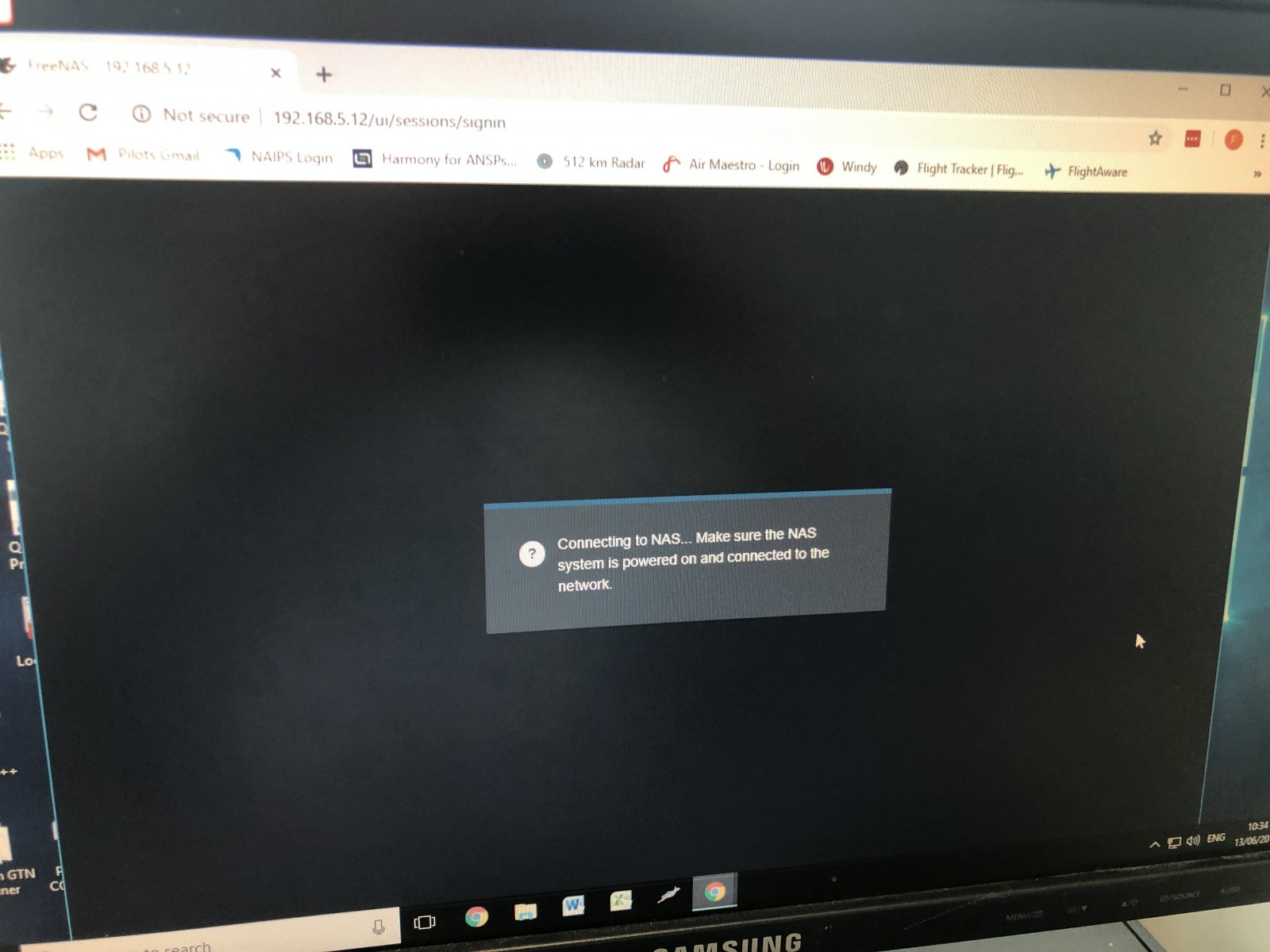

Came into work and tried with a local computer. Same issue. I can’t ssh as root so can’t even clean reboot the server.
