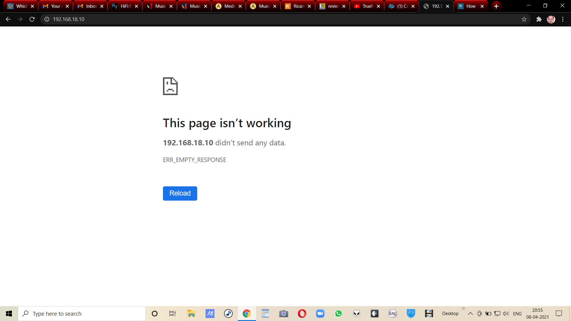

your windows is attempting to connect you using the current user/password. you need to check the box and use a different credentials.
When I type this IP address in chrome I get the following.

Everything is working now. While changing various network settings in the laptop and also in the modem I messed up big time. I was not able to connect via wifi and no internet access was avaialble.
Then I logged to the modem from the phone and changed the SSID and password and again everything started to work again including accessing the TrueNAS from the laptop.
