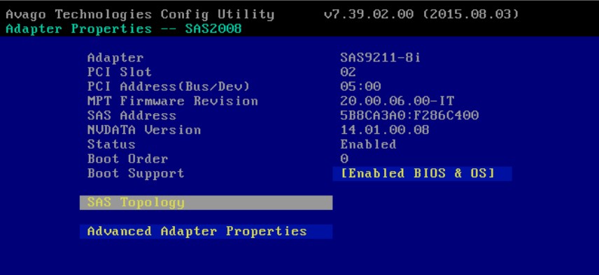

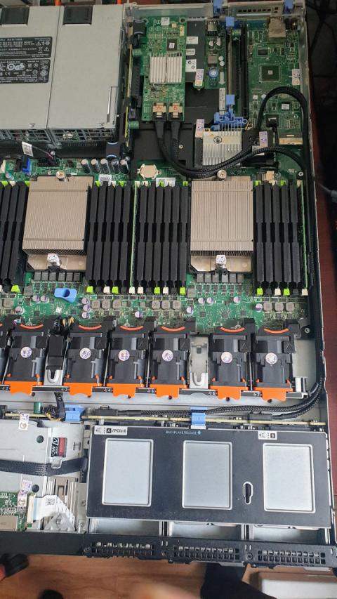

I received H310 IT mode and some sff-8087 cable and set up to my dell r620 like this. BACKPLANE SAS-A and SAS-B connector connect to H310 in PCI card.

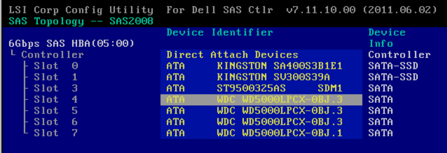

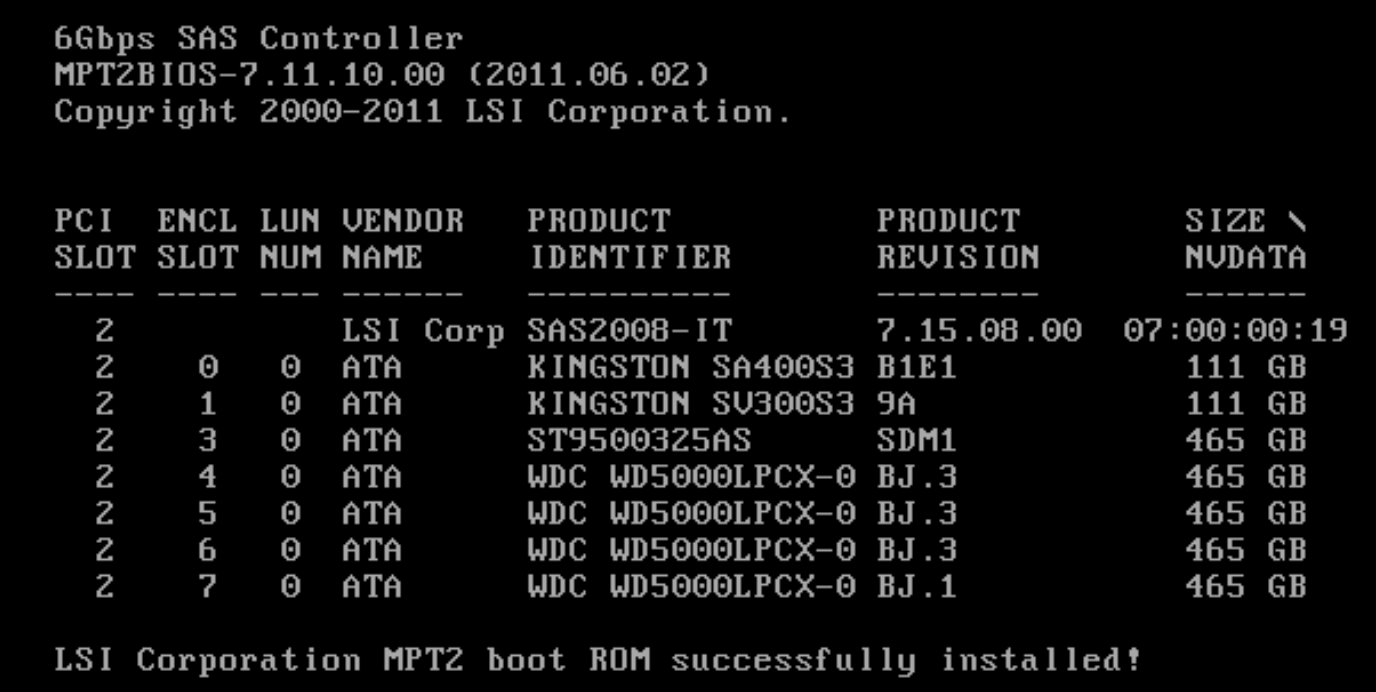

As a HBA card, in bios and HBA configuration i can see all my hard driver like this:

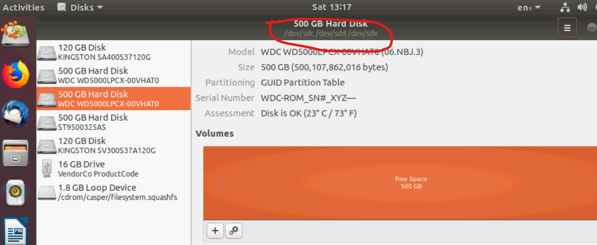

But in OS: FREENAS, WINDOWS server 2016, Ubuntu 18.0.4
I can not see all the hard driver, there are 3 hard drivers in the same hard disk, sdc/sdd/sde
this also the same problem when i install freenas.

One detail: You want firmware 20.00.07. The .06 version has some sort of probably nasty bug that was patched pretty quickly.

Last night I tried to format all disk by using format option in LSI configuration GUI. but nothing better. i will try to wipe by ubuntu. Luckily, GParted can detect all drivers. I think the problem is hard driver themself, i connect them to SAS connector on mainboard, I got the same problem.
