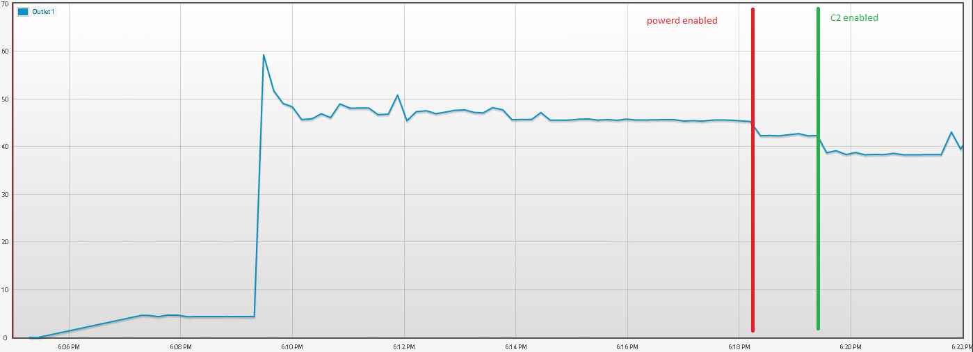

After a couple of years with FreeNAS on an AMD Athlon II X3 415e (3 cores @ 2.5 GHz, 45 W TDP) I decided to swap the CPU for an FX 8320e (8 cores @ 3.2 GHz, 95 W TDP) as this probably will be the last gasp for socket AM3+ and I'm not still ready for a full hardware upgrade. To make sure I didn't screw it up I disconnected all my zpool disks (6x 2.5 Samsung SpinPoint M7) and FreeNAS USB boot drive and installed Windows [ok, shame] to a new 2.5 drive do some stress testing with OCCP, Prime95 etc.
Under Windows my ElCheapoWattMeter showed anything from 45 W idle to 170 W at full load, but after reconnecting the zpool drives and booting FreeNAS again, idle power hovers around 100 W... something didn't quit feel right, so after some googling I got to this thread.
After setting hw.acpi.cpu.cx_lowest=C2, idle power went down to 55 W. That 10 W difference when idle seems consistent with the difference in the number of connected HDDs.

I just tried setting the lowest state to C2 on an FX-8350 using a 4-drive Z2 pool.
My idle power dropped from 120W to 83W, with the drives still spinning and a powerd daemon that won't start because I have an AMD CPU.
That's a savings of 37W and a decrease in energy cost of 31%.
Wow. The savings can be so significant that I don't understand why the devs continue to turn a blind eye to this.

I think it was worth it -- I just cut my box's power consumption by 54%. :D
CPU operate at MHz frequencies. Dropping from C1 to C2 shouldn't impact "peppy performance." I've observed no perceptible change in responsiveness of the system, which is to be expected because on a human time scale the C-state transitions are instantaneous (microsecond events). Anyone who is interested in power savings is more likely to create a latency problem by spinning down their disk array. C1/C2 C-states? They're not worth worrying about in terms of system responsiveness.
As far as power management goes, the only problems that need to be directed upstream are the lack of support for AMD-specific power management. that's definitely an upstream problem. From what I recall in examining the FreeNAS scripts, they purposefully set the C-state to stay at C1 during system initialization, which means that never entering C2 is a FreeNAS development decision and is not an upstream support problem.
In keeping with the bringing of good news: Last night I set the 4-disk Z2 pool to spin down after a extended period of non-use and this morning when I checked the power meter my system was idling at 55W.
That's quite an improvement from the 120W baseline at idle. The combination of C2 and spindown changes have decreased idle power consumption to 46% of what it was before. I think the saving of 65W when nobody is using the system is significant.
I hope that this info might help someone else who's having problems with high power consumption on an AMD box. Cheers.
