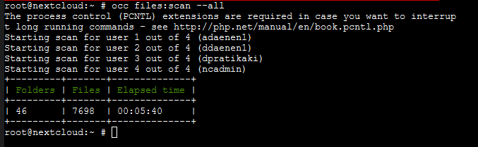

Have you tried
occ files:scan --all
from within the jail shell?
Worked fine for me
