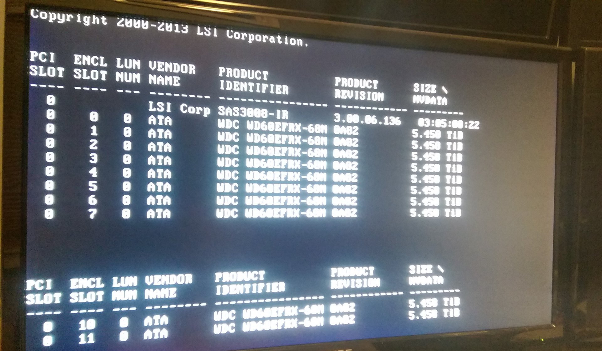

It's ALIVE!! That $20 cable did the trick.
Now time to install FreeNAS

Excellent. My guess is he was warning about lacking sas3 speeds or something with that backplane. On to the burn in and testing. :)
You were right all along mjws00. He clearly said it wouldn't work period. I guess that proved him wrong. I won't get 12Gbs speed, but that's OK. My upgrade path will only grow from here.
I guess the LSI 3008 can handle up to the 1000 drives it mentioned on the LSI website. I clearly have 10 drives connected without a problem.

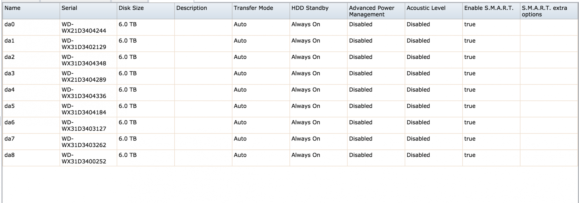

Question:
I just installed FreeNAS on my 16GB flash drive. Why I'm I only seeing 9 drives instead of the 10 drives I have connected?
