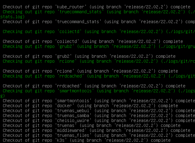

I know little about it myself but from what I scraped together reading their git-page you set the environment variable TRUENAS_BRANCH_OVERRIDE to the branch you want to build. The available branches are listed on the Github site.
If I were to try it (which I can't since I lack a build environment that is has the dependencies configured) I would try:
setenv TRUENAS_BRANCH_OVERRIDE "release/22.02.2"
And then proceed as instructed on the Github.
Edit: I spun up a VM with Debian 11 and set the environment variable as appropriate and it started building the latest release as can be seen here:
I'll leave you to sort build errors after that on your own. :)
