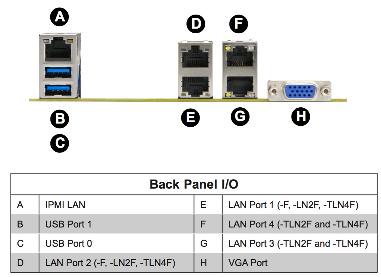

About the LAN ports...
A is the IPMI port
E is Lan Port 1 (gigabit)
D is Lan Port 2 (gigabit)
G is Lan Port 3 (10gbe)
F is Lan port 4 (10gbe)
The IPMI port will (by default, this can be disabled), fall back to using Lan Port 1, if the IPMI port is not connected. This means that at a minimum you can connect a single cable to Lan Port 1 and get both IPMI access to the BMC, and LAN access to your ESXi/FreeNAS/etc installations.
ESXi (6.5u1) does not include drivers out of the box for the Intel X557 chipset, ie the 10gbe ports. Thus in order to setup and install ESXi we will need a lan cable connected to Port 1.
Once we have ESXi up an running, we can change that to Port 3 and then use Port 4 for SAN access. Ideally you want to have your SAN traffic segregated from the rest of your LAN, because generally LAN traffic will trigger SAN traffic (or the other way round), and the last thing you want is one to cause a collision with the other, also it helps to remove broadcasts from the SAN.
Now, if you decide to setup pfSense as an internet gateway, you probably won't have more than a gigabit uplink to your internet connection, so it makes sense to use the gigabit ports for pfSense. So one would be LAN and the other WAN.
Do NOT use Port 1 for the WAN! The reason is because the IPMI port could failover to Port 1 and be exposed to the internet! Instead use Port 2 for your WAN and port 1 for your LAN. If you want to prevent the IPMI port being on your LAN (say you have a management network), then you can disable the fail-over in the BIOS, and connect the IPMI port to your management network, if you had one.
If you do have the IPMI running through Port 1, then I found that you lose access to the IPMI during the early stages of reboot. Not a huge problem, but there ya go.

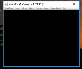

Installing ESXi via Supermicro IPMI
Next, spin up your Java enabled web browser that you use for IPMI Virtual Media mounting. I use IE11 in Windows 10 in a VM on my Mac OS X box. You can't (currently) mount virtual media through the HTML5 iKVM unfortunately.
Then log in to your IPMI console. If you don't know the IP address of your IPMI, you can see it on your BIOS boot screen. Or you can perhaps find it on your routers DHCP list, or you can use the IPMIview app to scan your network segment.
Remote Control -> Console Redirection, then Launch Console
And then click through the 8 or so security warnings. Best not to update Java... its liable to lock you out.
The Java iKVM in all its glory.

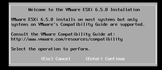

ESXi Installer starts...
Note: Build 5969303 is 6.5U1.

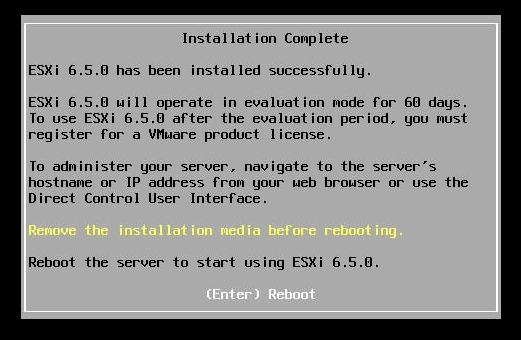

Yeay. Time to unplug the virtual media.
Plug-Out OK!! Stop!!
And then continue the ESXi reboot process...

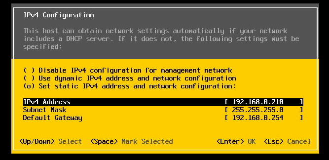

So, since ESXi doesn't support the X552/X557 10gbe ethernet ports out of the box, you may have not remembered to connect your network to gigabit port 1... and if you did forget, then you'll get this...
...so to fix the "http://0.0.0.0/", just plug in your network to Port 1 and restart...
And this time your hypervisor will probably pickup a DHCP address. We'll change it to a static IP when we setup our 10gbe ports.

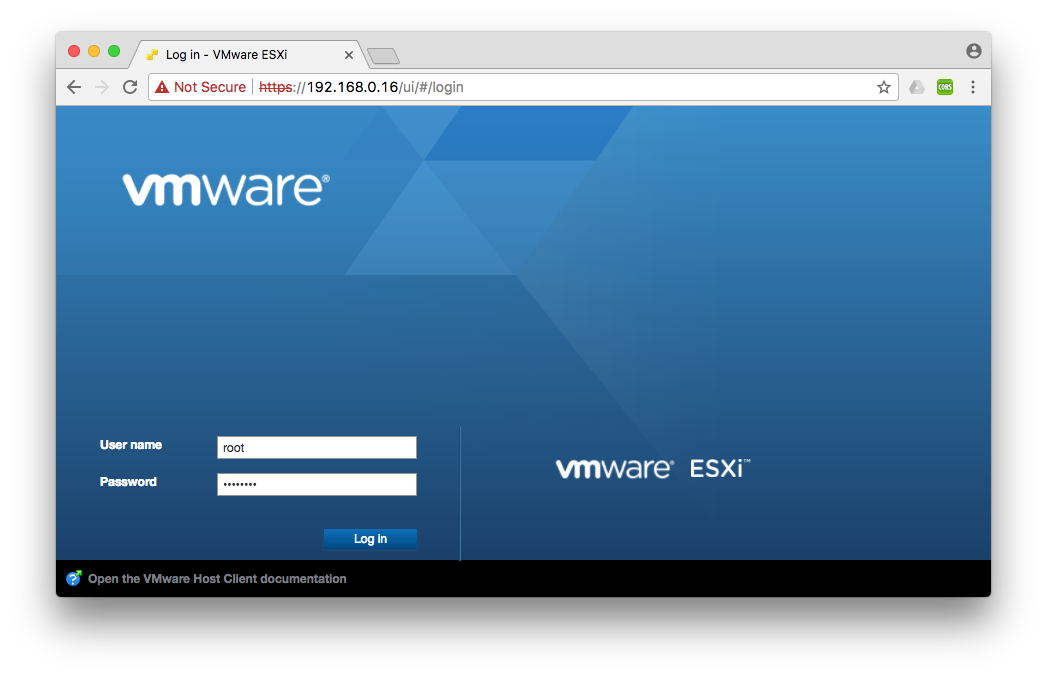

Logging in to the ESXi GUI
Login to ESXi's web gui, at the management address on the console screen, Chrome works best.

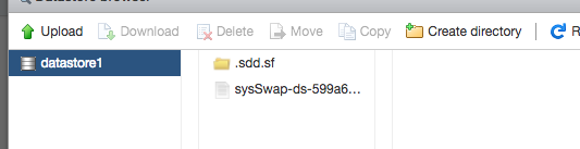

Enable Host Swap
We'll enable Host swap on your speedy m.2 NVMe boot disk/datastore. Host swap is used not only for the ESXi host to swap if it needs to, but for caching and for non reserved memory VMs to memory balloon, which allows you to run more VMs with less memory.
Manage -> System, Swap
Just set the Datastore to "datastore1", and enable all options.

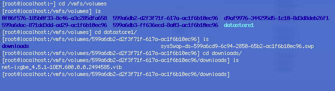

Installing the Intel X552/X557 10Gbe Ethernet Drivers for VMware 6.5U1
Networking -> Physical NICs
If you look at the Physical NICs in Networking you'll see that vmnic2,3 don't exist
Best way I know to find the right drivers is to search for it on the HCL
https://www.vmware.com/resources/compatibility/search.php
"ixgbe", and this is the one you want...
Which leads to this page...
And if you read all the release notes, you'll find out that the right version is 4.5.1, and not 4.5.2. 4.5.2 is specific to Fibre Channel.

Go to Storage, then click "Datastore Browser" to browse datastores.
I like to create a "downloads" directory on the root of my primary datastore... use the Create Directory button... then click Upload...

ssh in to the hypervisor as root cd/ls around a bit and get to our datastore...
The datastores are in /vmfs/volumes, in this case cd /vmfs/volumes/datastore1
And then the command to install the VIB is:
esxcli software vib install -v /vmfs/volumes/datastore1/downloads/net-ixgbe_4.5.1-1OEM.600.0.0.2494585.vib
You have to use a full path... you can use tab completion... I like to cd/ls around to see where I am... and then get the full path with pwd
And then the driver installs. A reboot is required.

I like to watch the hypervisor shutdown/boot via IPMI... then I know when its back...

I'm going to connect up LAN port 3/4 now... and disconnect Port 1. IPMI only ever functions through the IPMI port, or if failover is enabled, Port 1, so I already have a network cable directly connected to the IPMI port.
Of course, when you disconnect Port 1 you'll lose connectivity to your ESXi host... so, back to the IPMI iKVM console again.

Edit the IPv4 Configuration
I'm going to use static IP. Because we used DHCP initially, the gateway, netmask and DNS information are already correct.
Stux
Jun 2, 2016
4,419
Exit out, and restart managment network.

This is actually the last time you ever need to use the esxi console again.
Lets log back in to ESXi GUI on the above IP address...
