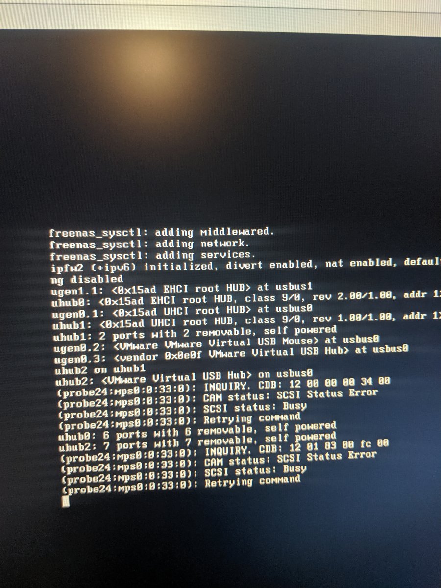

Hey guys,
I just had the board fail in my stand alone system for freenas and now for a couple months until I can upgrade that I need to move Freenas to a VM with Passthrough. I am on ESXI 6.7 and running freenas 11.2u4. whenever I power up the VM it start the boot process and goes until I get error "(probe24:mps0:0:33:0): SCSI Status: Busy" and then immediately reboots. My setup and specs are below. I have the EXP3000 Plugged in to the LSI SAS9211-8i with using a single cable to the 'in' port on one of the ESM modules. The vm will keeping rebooting at the same point over and over. If I unplug the Sas cable connecting the enclosure the vm will boot fine. If I wait until Freenas finishes booting I can plug the SAS cable back in and then import the pool and everything runs fine until I need to reboot again. I attached a photo of the error which more details. Any thoughts here? Side note all disks are reported as healthy within freenas when I plug in the enclosure after letting it boot up. I'd really love to figure this out as I remote in to my lab to find myself rebooting a lot(self inflicted) and can't always unplug sas cable during boot.

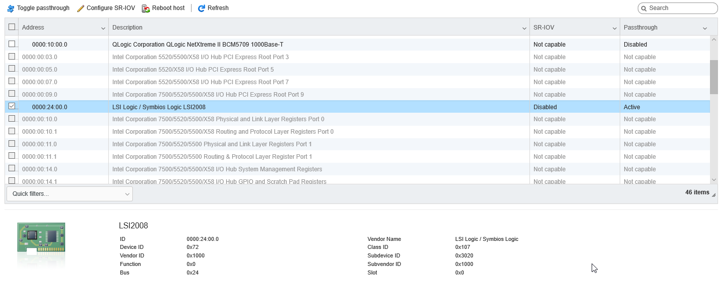

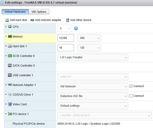

Thanks for the reply. I had reviewed 2 of those links before I started with the freenas install on VM. I have enabled Passthrough under the hardware section of the host as shown in the first image below. I then have the VM configured as in the second screenshot.

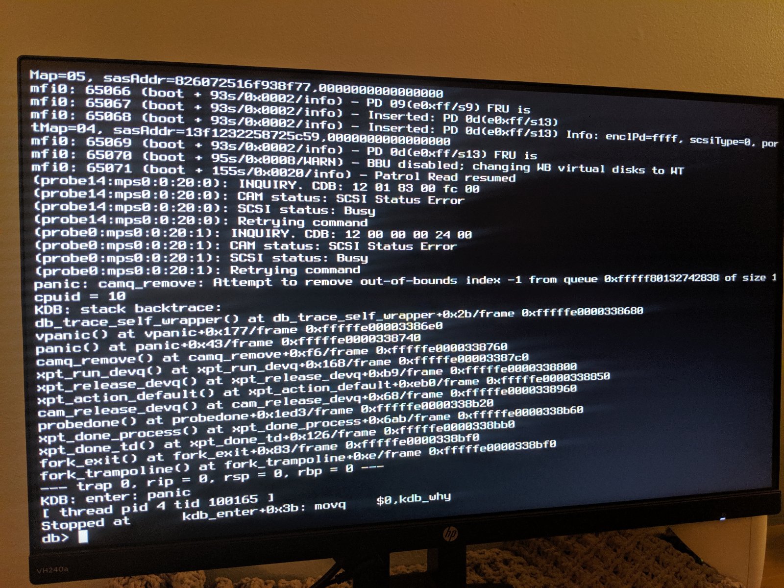

so I did some additional testing and in an attempt to narrow down the issue I booted the host to freenas installer and installed a flash drive. The install goes fine and will complete the boot process without any issue if the EXP3000 is not connected. If I let freenas boot fully and then plug in the enclosure all disks in the exclosure are detected and run without issue until a reboot. At which point the same error is displayed. The only difference with this is that the system does just keep rebooting like the VM. This stays at a KDB panic. New screenshot of error below. So this does not appear to have anything to do with freenas running as a VM in ESXi. Hoping this changes the direction and someone has a thought or suggestion to try. I have been searching various sites and not turning up any results. The closest thread I can find is link below but a resolution was never found. The errors are almost identical though. The last thought was firmware for the enclosure but I cannot download the files from IBM without a support contract. I am still trying to find the files through an alternative means.

Updating this at this point just for completeness sake. I am at this time unable to get the EXP3000 to work with freenas 11.2U5 or any earlier version.
I had bought a new SFF-8088 to SFF-8087 cable and get the same results, cam status busy timeouts and then a KDB panic. I pulled all the drives form the encolure and there is no change either. After many many hours of testing options was able to get a couple times of plugging in the enclosure after fully booting freenas(no longer in ESX and is installed to a 16gb usb drive on the server) where freenas detected the enclosure and all 12 drives. I also tested the enclosure with an entirely physical server and get the same issue. Rarely when freenas does detect the enclosure without causing KDB panic I was able to identify the device that camstatus returns the errors for and then crashes. It is SES0 which to my understanding in the ESM module in the enclosure. I have dual esm in this enclosure and I have tried all the combinations on 1 at a time and in each slot with no change. When reviewing the firmware update change history(see below) it specifically calls out panic issue in many of the versions. The real kicker here is that IBM requires a support contract to download the firmware(consider the latest release of the firmware is from 2012 it blows my mind that this is still the case.)
