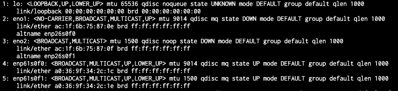

jonboy345
Nov 6, 2023
3
They do not have the same mac address:
