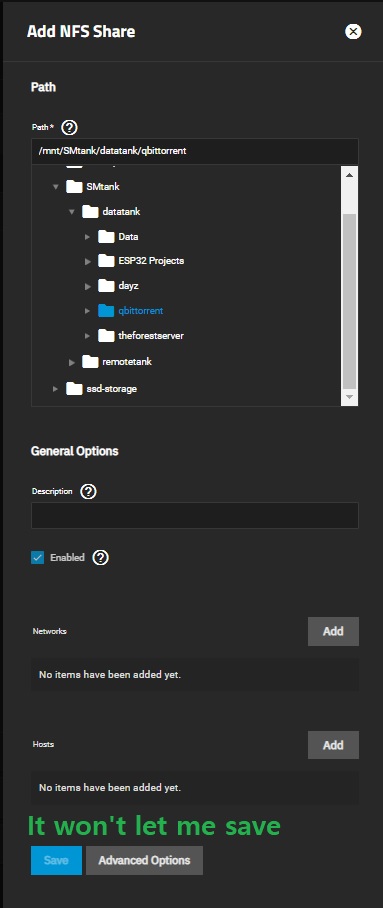

Hey all,
Like many after the recent update to 22.12.1, I have been changing over apps to use NFS inside of my SMB share.

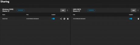

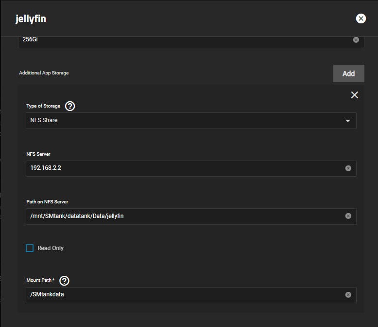

Firstly, for some reason if I try to follow the guides and make multiple NFS shares for each folder that I need, it wont work. it seems like I can only create one NFS share per dataset, no matter the directory. So I created one back a file and set each app into its place. (see the jellyfin example)

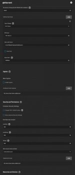

Second, even though I got it to work for other apps like Jellyfin, I can't get qBittorrent to save to the directory, it will "error" with no data saved.
any ideas?

Can confirm, cannot add a second NFS share on the same dataset even if it's not part of the same subtree.
If my dataset is for example documents, it seems I cannot share these 2 folders separately:
  • /mnt/data/documents/folder1
  • /mnt/data/documents/folder2
Bug?
9,700
No. This is how NFS works. One "share" per filesystem.
But your clients can easily mount at multiple points of that filesystem if you just share the root of it out.
On the other hand... if you want to keep your apps from having access to the same data for some reason... 2 child datasets would be fine.
  • /mnt/data/documents/dataset1
  • /mnt/data/documents/dataset2
for example.

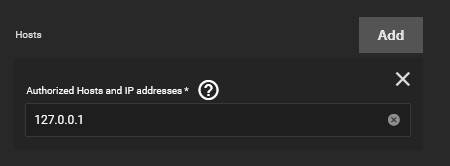

Also, if you use these shares for apps only, restrict the shares to 127.0.0.1 only.

In the logs it states the path to what is should be saving or accessing. The path looks right but says "permission denied".
Apps is added to the group for the share, so Im not sure what the issue is with qbittorrent. It worked fine before updating and having to use NFS share

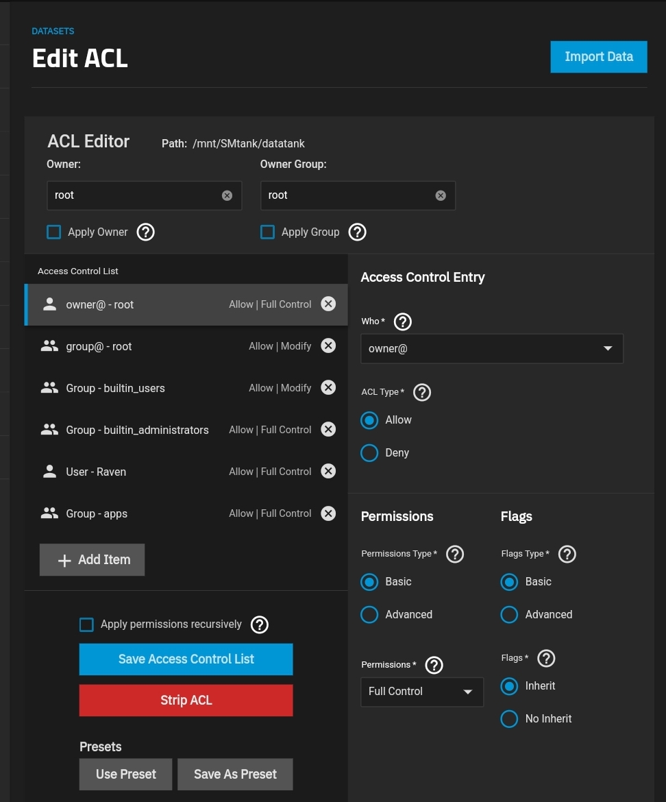

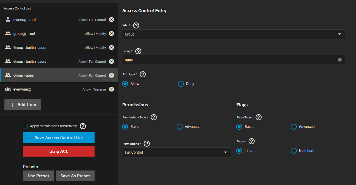

When you added the apps group, what permissions did you give it? In case of qbittorrent, depending on the configuration, you may have to give it Full Control at the dataset level and apply it recursively (at least if the dataset it not empty) as it may need to move stuff around or create sub-folders and delete old ones.
Something like this (dataset created with SMB type ACLs):
The NFS share itself doesn't have anything special, it's a good idea to limit access to localhost only if the share is there just for apps:
User 127.0.0.1 as server in the app configuration in this case. NFS is mounted by kubelet (part of k3s in this case) which is running on the host, so localhost is always accessible.
apps has full control, just like you have it.

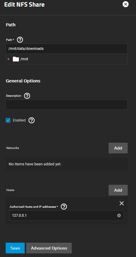

Ok so I just gave it a shot myself, with a setup like this and it seems to work just fine..
Share is: /mnt/data/downloads
Ownership of the qbit folder is root:apps
The /mnt/data/downloads/qbit folder is mounted from 127.0.0.1 under /downloads
The group apps has full control over the /mnt/data/downloads dataset.

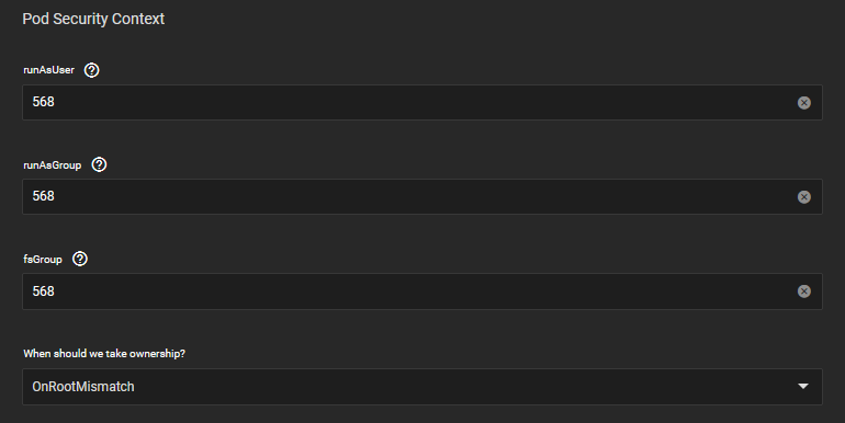

Qbittorrent is running with this pod security context:
Everything seems to check out just fine. I did change settings inside Qbittorrent's configuration to download to /downloads so make sure you set the path for you case too.

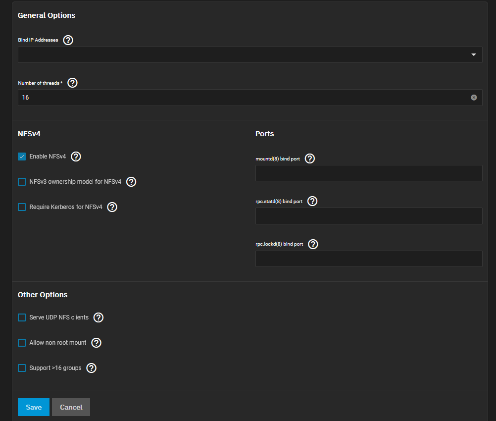

Edit: I have NFS v4 checked under the NFS server options btw, bit sure if it matters or not, probably not.

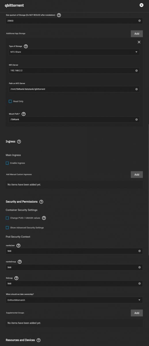

Everything seems the same with my setup although I wasn't using NFS v4. I enabled that with no luck. Its still not working.
So it still wont mount or have permission to

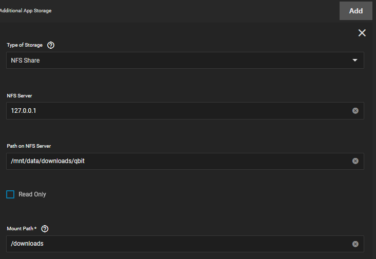

I'm not sure why if I try to use 127.0.0.1 as the mount address instead of the server IP, none of my apps can connect to NFS
RavenNAS
Mar 7, 2022
34
with help of truecharts support we found that the mount has to be /downloads. I had changed it and although it worked before the switch to NFS, it seems to be a requirement. now it works
