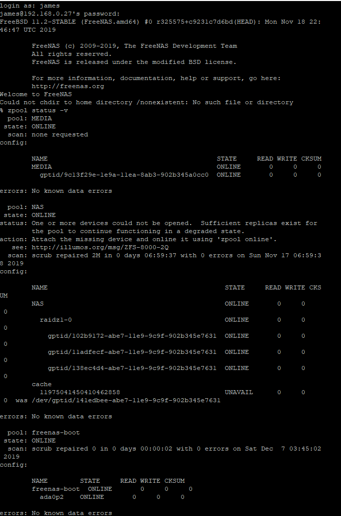

Hello, complete newbie I'm afraid. I've had a freenas server made from running for about 6 months now. I had a hard drive failure on a drive (just games so its ok) and swapped in a new drive. Whilst copying media files to the new drive the connection suddenly dropped on my windows machine, (internet and local). After this I cannot access my NAS from my windows machine, It either cant map the network drives or with SMB1 enabled can map them but cant access them. I can access my freenas dashboard fine, as well as my pihole console but not my plex server (locally or remotely).

Can you access the NAS by Web GUI and/or SSH?
What is the status of your pools? (zpool status -v)
Can you confirm that the SMB service is running?
I can access via both webgui and ssh. Pooll status is all good, only issue is missing cache on one pool which was a failed msata SSD but that failed months ago and the NAS has been operating fine since.
SMB service is running and SMB1 is enabled on PC and on Freenas I can now access the storage after adding my credentials to the SMB1 settings on the freeNAS but im stuck at 11.3MB/s whereas I was at gigabit speeds before.
In the end I deleted my plex installation to reinstall it however my reinstall fails with error: [EFAULT] Exception: CallError:[EFAULT] An error occured! Please read above occured, destroyed plex-plexpass.
