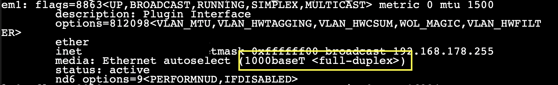

If your target PC does not have a GUI, then use the command ifconfig. You'll see a output similar to:
Also make sure that 1000baseT is shown at your desired interface.
