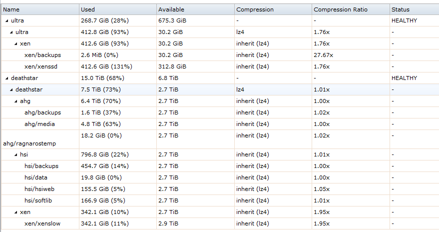

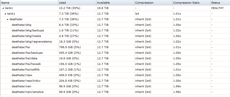

Not sure if this belongs in a new thread or what, but its related to the above so here's the latest.
Got replication working after creating new periodic snapshots with a longer life time. All three top level data-sets recursively replicated with no indication of error.
However, not sure if this is just something odd, or a bug, or if it has any underlying impact beyond the visual difference, but now I have two servers both are on FreeNAS-9.3-STABLE-201509282017 and on the original system the data-sets in the volume tab looks like first screenshot with collapsible trees. Then after I did the set of three recursive replications to the new system, structure of the trees match but are not collapsible.
Also on the new system you can see two small data-sets that don't exist on the original(deathstar/resx, and deathstar/resx/trdcv).
Does this matter? Why did it happen? I've rebooted both systems as well and the condition persists.

rogerh
Apr 18, 2014
1,111
I wonder if you had any such dataset at some stage? Can you see any files you recognise in /mnt/tank1/deathstar/resx or directories below? Have you any snapshots with the same dataset name on sending machine? If not, it is really rather worrying!
Edit: if there are no snapshots of /trdcv on either machine then I have another theory and I would search the command history on the receiving machine for trdcv.
monovitae
Jan 7, 2015
55
Never had anything of any sort named resx or trdcv. I'll grep out both of them in the shell and maybe mount them to see whats inside. If anyone else has any theories let me know.
