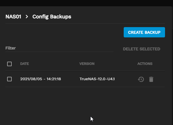

Having a hard time figuring out how to get it to do Automatic configs, is this something that happens on some kind of schedule?
No information in the settings page, just that its set to keep 7. I did some manually as a test which worked (No idea where they are stored though)
I changed some settings on one of my boxes to see if it would save the config, and no new backups showed. Does it take some time?

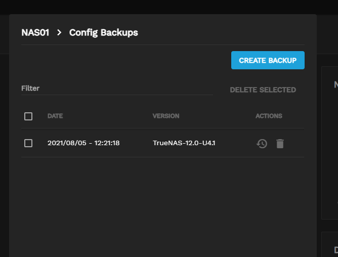

The TrueCommand looks cool, but so far I can only get it to save 1 config? I have it set to save 7 which is default, but all I get is the last
Here is one it made
Just checked now, and there is still one, but its later
And the directory I set for data is still completely empty
