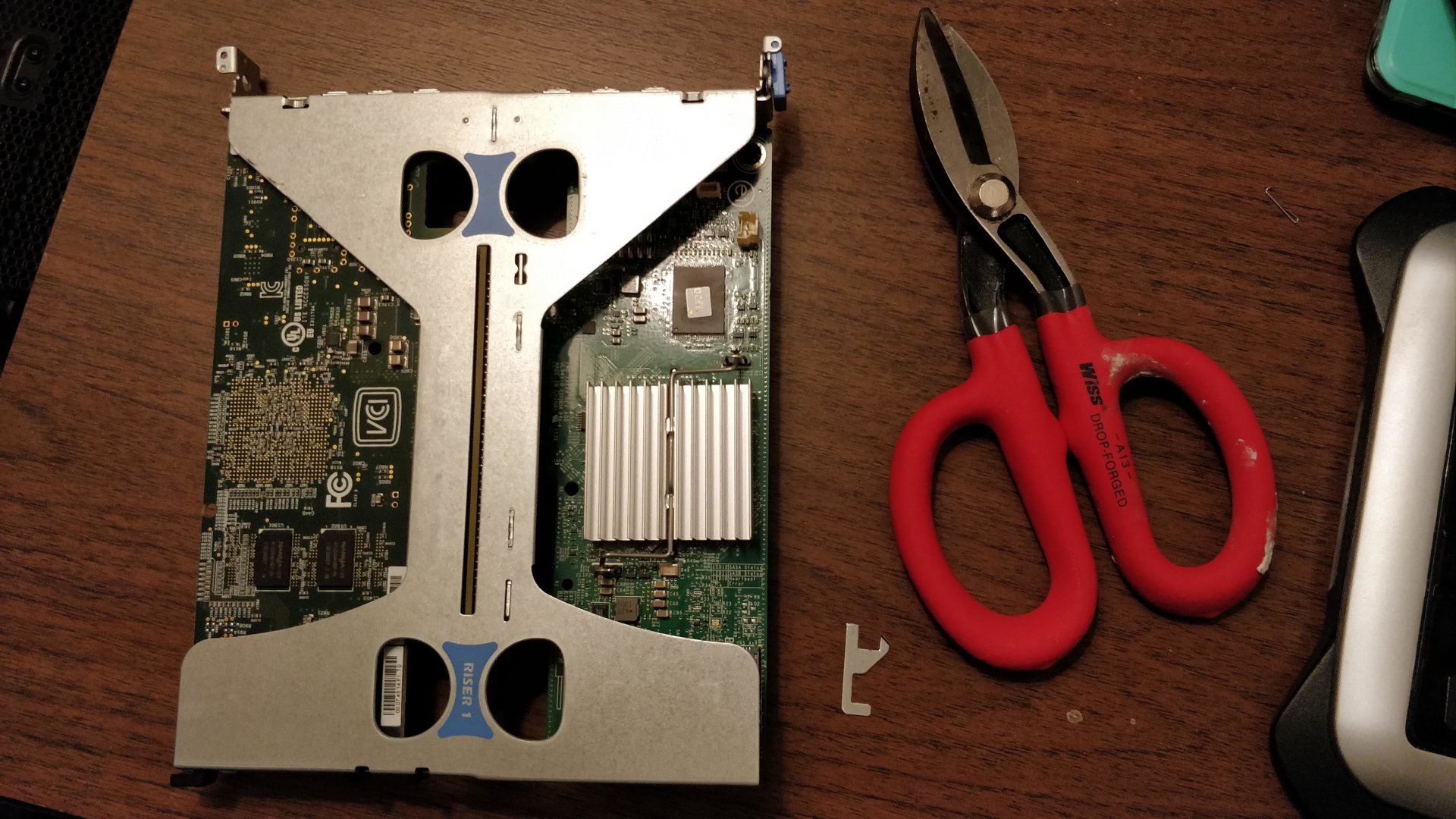

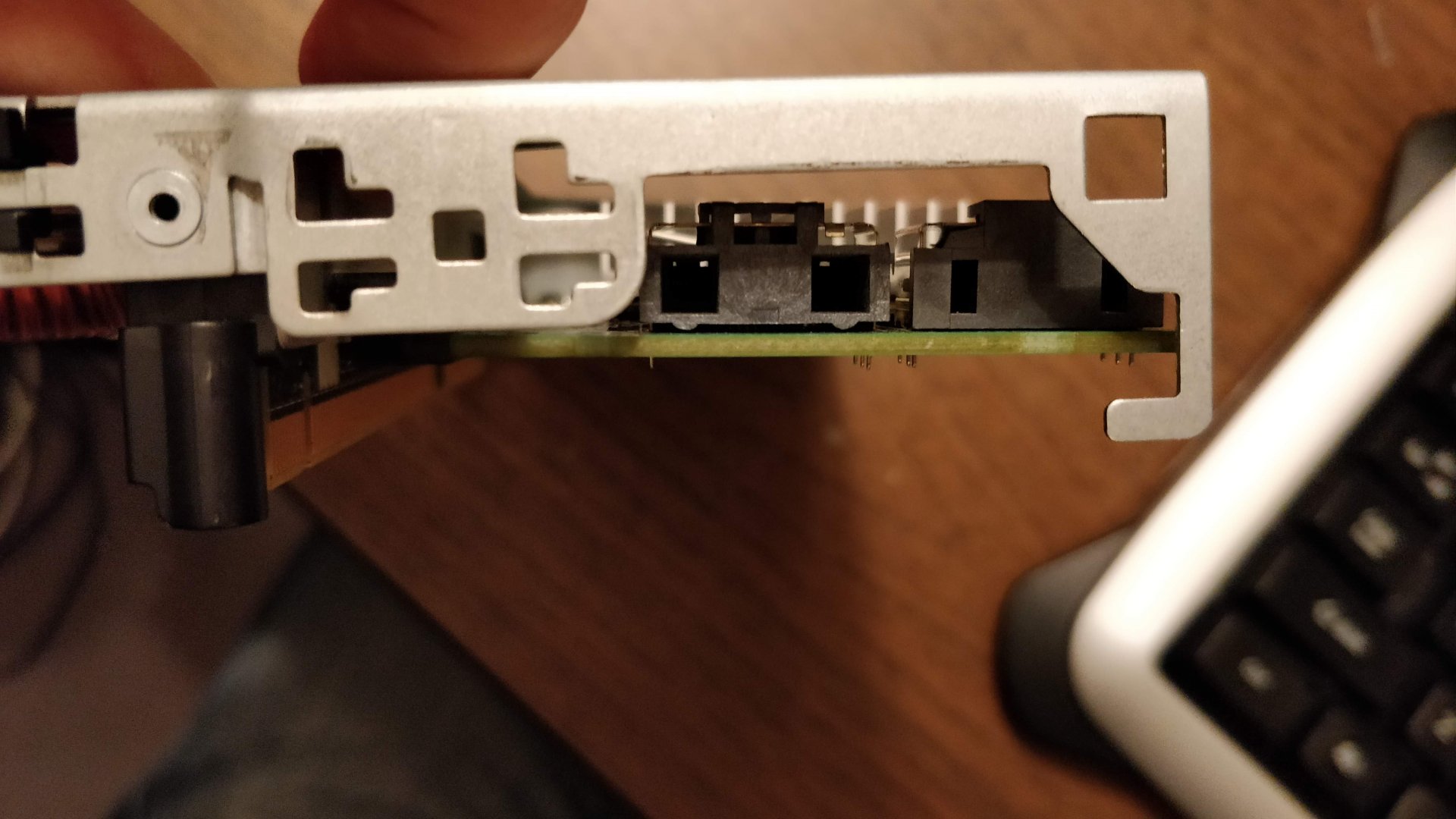

talz13
Oct 5, 2016
19
Just FYI, I have recently purchased a used Dell R620, with the same plans as you... I went and got a PCIe H310 off ebay, and find out that it does not appear to fit with the riser card mount. I mean, the card will fit fine, but the SAS ports are directly against the inside of the riser mount, leaving no room to plug the SAS cables in.
I did get cables with 90 degree ends on them, but they'd both be pointing the same direction, and would not be able to be plugged in next to each other, as they'd end up overalpping.
If you get any further with this, or if anyone else has suggestions, I'd be happy to hear. Right now I'm thinking of getting a SAS external to internal adapter plate and run the 2 backplane SAS cables off the external LSI 9201-16e card that I was already going to install to attach my DAS.

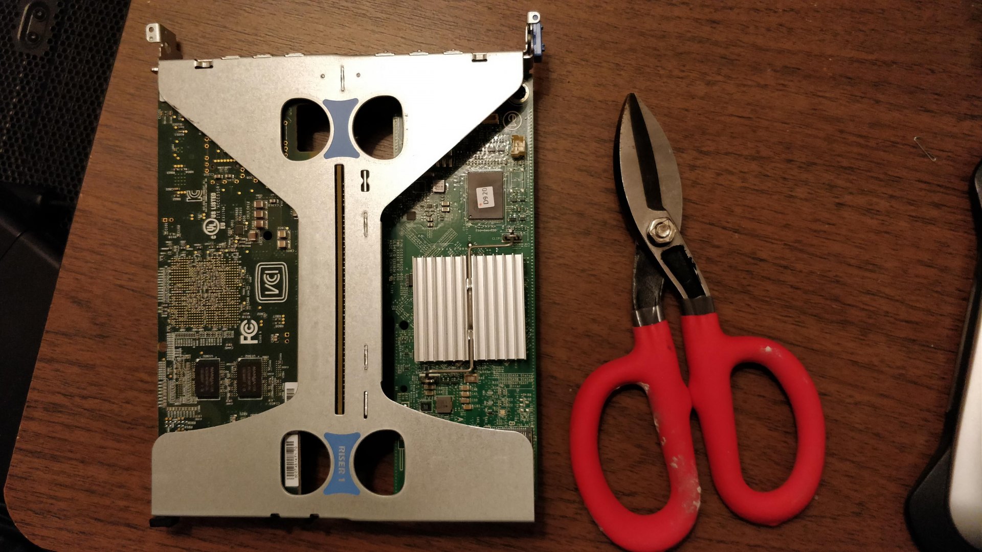

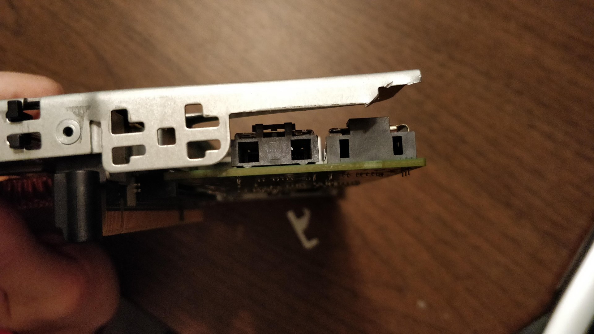

I believe I am going to go the tin-snips route, and investigate clipping away the riser cage to allow access to the SAS ports on the PCIe card.
talz13
Oct 5, 2016
19
I am planning on doing the same if needed.
Here's my progress tonight...
1. Gathered the tools!
2. Analyzed the situation...
3. Snip snip!
4. Voila!
Not pictured is the very first step where I took a small screwdriver to remove the black plastic retention clip on this side of the cage.
I've ordered some new straight-through (not 90-degree end) 0.7m sff-8087 cables to try out, hopefully that length will be good, should be here by next Tuesday.
