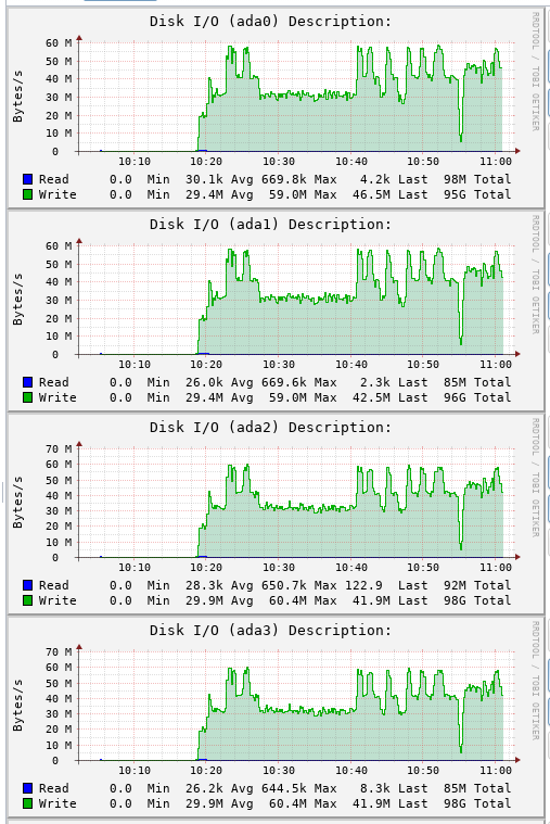

It helped a great deal, but I am still seeing some drops in performance. Its the same pattern as I was seeing before but the drops are WAY less severe now (ignore the huge drop, I paused a transfer there):
I am thinking maybe I just need to go up to 24 or 32 gigs of ram at this point? Any ideas what it means that the slog helped a ton but didnt totally fix the issue? Before I the slog I was seeing the lows around 20-30MB/s instead of 40MB/s

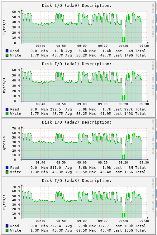

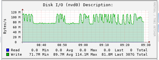

Also, what is the average write throughput of the pool with the network out of the equation? That may still be a bottleneck. (Doubtful, but has it been tested?) You mentioned the pool was a striped pair of mirrors. Ok, so on your graph half the data is going the one mirror, half to the other. Each half looks to be 40 MB/s on the low end, 60 MB/s on the high end. So 80-120 MB/s for the pool.
That matches what would be flushed from RAM to the pool as the SLOG is showing 80 MB/s on the low end and 115 MB/s on the high end (which is what you would expect for a GB network, and matches what you saw with SMB). So are ALL the writes SYNC writes? It appears that is the case.
What happens when you do some dd testing on the pool (compression off, large block sizes, 5x or more your system ram size for the transfers)? What sustained write and read performance are you getting?

After the dip between 10:50 and 11 is where i turned sync off. Still not maxing my network connection. I can borrow ram from work so I am going to plan to do that and see how it acts with 32 gigs. Ill also do a dd test on the pool and see what I get
