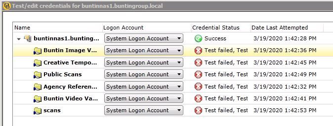

Mar 19, 2020
3
Is there a resolution for this. I upgraded this week from 11.1U7 to 11.3U1 and getting the same issue as OP. When I test the backup credentials in Backup Exec 2012, I get success to the FreeNAS box, but not to the shared volumes on the NAS. See attached image.
