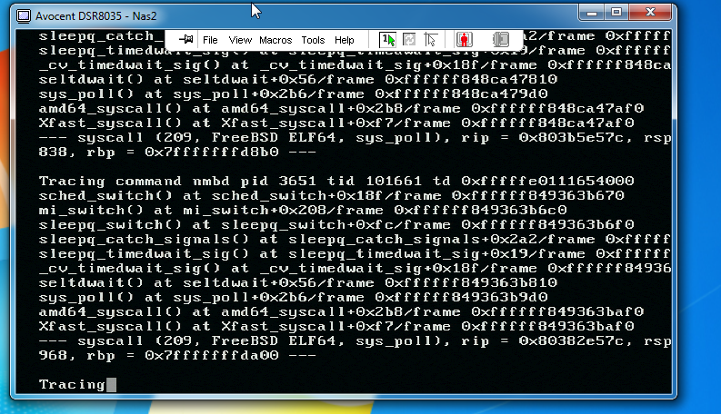

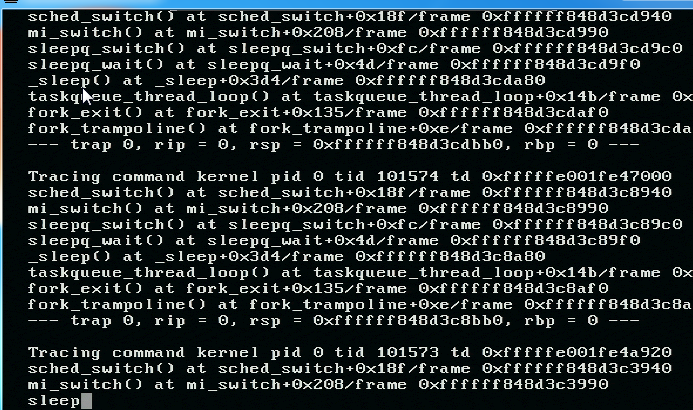

I had a small problem with my filesystem which ran full b/c freenas chose the one with an iscsi vol on top of it as system vol...
After experiencing weird issues (and some error messages) i removed the volume and rebooted... only to find i could'nt run smb (no samba config file (?) ) so i rebooted again...
After that the system rebooted itself (? maybe kernel panic) and turned on a trace mode which is currently running and blocking everything... no gui, no ssh
This doesn't look intentional... Or its not a good idea if it is.

Reboot tells me WITNESS option is running - how did it get there
System comes up fine, gui ok... but as soon as i try to connect via CIFS ... same problem.
This goes for a while and then reboot again.
Its not really an issue, i am still testing stuff and dont have live data on the system.
I played around with tunables/sysctl values just before that (removing values for a 10gbe test and yes via gui not in files), maybe that caused an issue if the config files could not be written properly...
last reboot triggers another dump of interrupts again, but this time its fast at least.

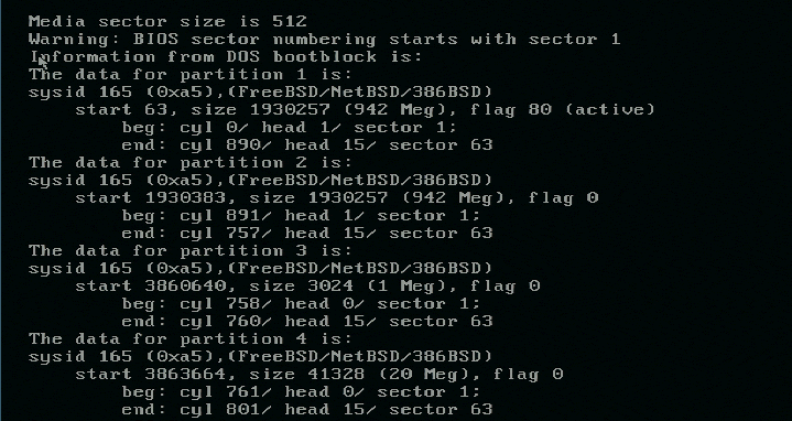

Ok ... there's something i dont understand...
According to the manual a 2GB Flash drive is sufficient.
I have just removed all partitions from the 2GB eUSB and installed 9.2.1.2 new, choosing "Install New", wipe partition.
Now i end up with a 1GB partition which is 97% in use *and all my config settings are still there*.
1. Wtf is my config still there? Does it autoimport it from the .system dataset (which still exists) ?
2. Why is it only using a 1GB partition for / when the drive has 2GB space?
I have 26972 bytes left... *Anything* writing to / (like that samba kernel dump i just deleted before me prevous post) would cause the disk to be full and possibly cause the panic.
And i saw an option flashing by turn_on_debugging_on_panic=1 ->1 so i guess thats whats happening here?
I mean easy workaround using a larger drive but before i go ahead i do that and create a bug re documentation i want to have somebody crosscheck my logic here please - and maybe explain why only 1GB is being used for / and what the other 1GB partition is doing?
