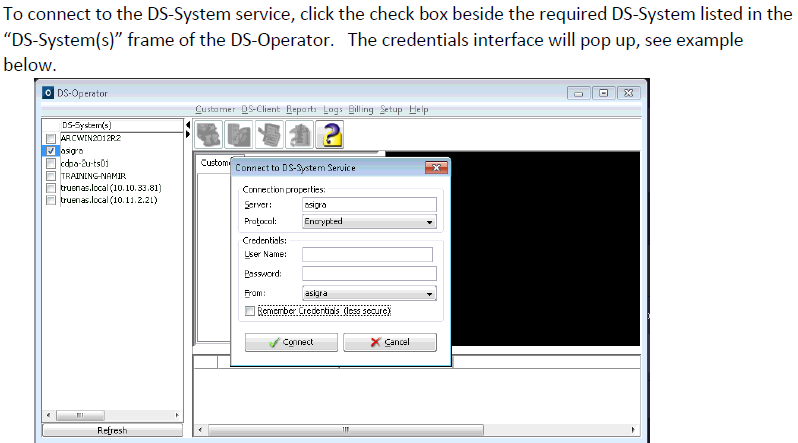

I have added a user but when adding one there is no field to put a password in, so when logging out and trying the new user, what is the password
Kevin2020
Jun 29, 2020
5

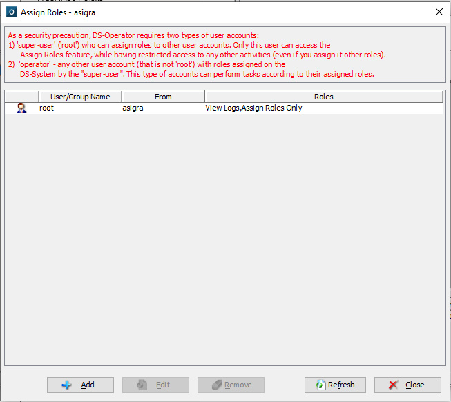

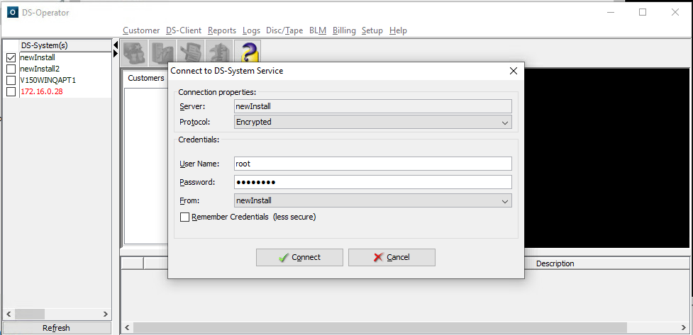

The DS-System GUI uses the Asigra Plugin jail's OS environment for authenticating users. You will therefore need to add at least one regular user to the Asigra Backup plugin jail. This user will be used as your DS-System service administrator. For security reason this user must not be a Super Admin user and does not need a login shell. You will also need to set the password of the root user for the jail. Note that the root user is by default the only user that initially has any DS-System GUI access. As a result you will first access the DS-Operator with the root user and then assign the appropriate DS-System role access privileges to the regular user you created. Note that for security reasons the plugin jail root user does not have full DS-System role access and can only be used to assign these roles to other users.
So in a nutshell before you get started using the DS-Operator there are two things you need to get done:
1) Set the jails root user password [ Access the jails shell and enter command: passwd , then enter the password you want. see example screen clip ]
2) Create at least one backup admin user in the jails OS. [Access the jails shell and enter command: pw useradd <username> -s /usr/sbin/nologin
then set the password for this user by entering the command: passwd <username> . Important: Ensure you replace <username> with the user name you want to use: Example, say username I chose was backupadmin, then to create the user enter:
pw useradd backupadmin -s /usr/sbin/nologin
To set this users password enter:
passwd backupadmin

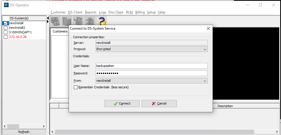

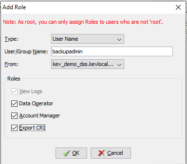

Now that you have created you backup admin user the next step is to inform the DS-System service about this user and the role(s) it should have. To do this you must log into the DS-Operator as root.
Once you have logged in click Add, then enter the username of your user and select all the roles then click ok. See my example here.
you should see the username added to the list users. Originally it was only root in the list. Log out of the DS-Operator by clicking
Then log back in again this time using you backup admin users credentials.
