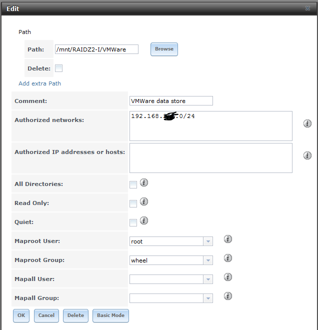

Here is what my NFS share looks like. I only share this with ESXi hosts, so all the traffic comes from root.
I could be wrong on this, so double check it. Maproot applies to connections from root (I know, duh). Mapall would map anything to the specified user. The inference I draw from that is that mapall would supersede maproot. I'll confess I only went as far as I needed to go to get my VMWare datastores working, and then my interest level waned rather rapidly....
