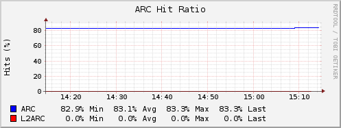

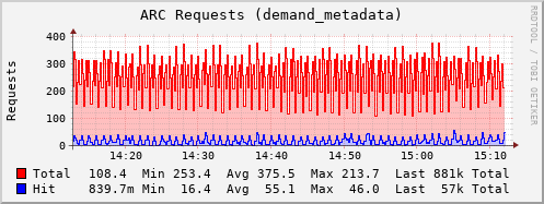

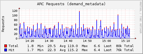

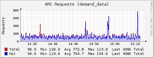

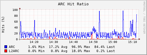

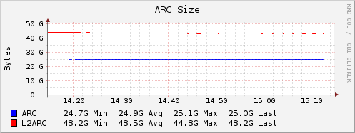

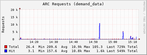

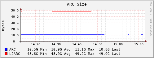

Hi all!
I need a help. I have two Freenas Boxes, one is using SMB (sharing VHD Files to HYPER-V), other is using ISCSI with Hyper-V too....
Hit Ratio is very low on SMB and very HIGH on ISCSI. WHY?
Have way to tunning it to be better on SMB?
I know that first box, have less memory (16GB) and Second has 32GB, but difference of HIT is so BIG.
Where is my fault?
Thanks a lot!
FREENAS 1 - SMB
FREENAS 2 - ISCSI

You hit ratio depends on if the requested data is in the cache. That depends on if the data has be previously read and ifs it's still in the cache. That means it depends on the size of the cache and the workload. If you playing movies over smb, you hit rate will suck because you read one big file once and fill the cache with something that you will likely not read again.
This is a bit of a simplified view but should show why it might differ. It's almost impossible to explain your hit rate without knowing EXACLT how your programs/you access the data. Access patterns dictate the efficacy of a cache system.

Only to know, both of FreeNAS are be using to storage VM (big VHD FILES), could you teach me please, if cache system sees the files or the blocks of the files, example, if I have an VHD with 500GB size, it need to be cached fully, or system can cache only the blocks more accessed?

There's about a 99% chance that you're using the default recordsize=128K on the FREENAS1 host. If provisioned disks as thick and you're having to do a 128K partial record rewrite every time, that could be destroying your random I/O performance as well as leading to it not being able to keep relevant data in ARC, which is yielding the poor hit rate.

Also to be clear the ARC cashing works on a block level, not file. On a side note, stick with vhdx unless you have a reason not to. (Rant) Or better, use ESXi, proxmox, the free xen, or any other hypervisor under the sun. (/Rant)

Technically it works on the "record level" but if it's having to read a 128K record just to find the 4K of data it needs, that's still bad.

HoneyBadger you are right it's 128K record size....I will change for 4K record size and rewrite all files. to check if cache is better.
