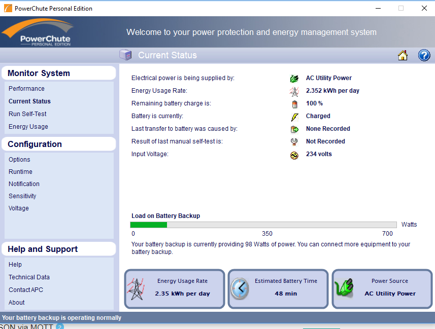

I'll hook up powerchute when I get home and see. 108 is real as it fluctuates.
230 / 110 * 108 = 225 which is not outside unreasonable with various margins.I'll dig a little.
Crispin
Jun 8, 2011
85
OK, hooked up PowerChute and get good data
So deff something wrong with nut and understanding the voltage from UPS.
