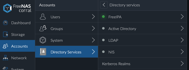

Anyone using Red Hat Identity, Free IPA with FreeNAS 11
Howard Swope
Nov 19, 2015
26
Just checking in to see if there has been any traction with this. Free IPA support was working in FreeNAS 10 (which I am still using). I obviously want to move to 11, but need it work with my security. Thanks for any information on this issue.

Thanks for the response. I may need to try to spin up a version in a vm and see if I can get it to work again. But it was just so easy in FreeNAS 10, I was hoping similar support would eventually find its way to 11:
