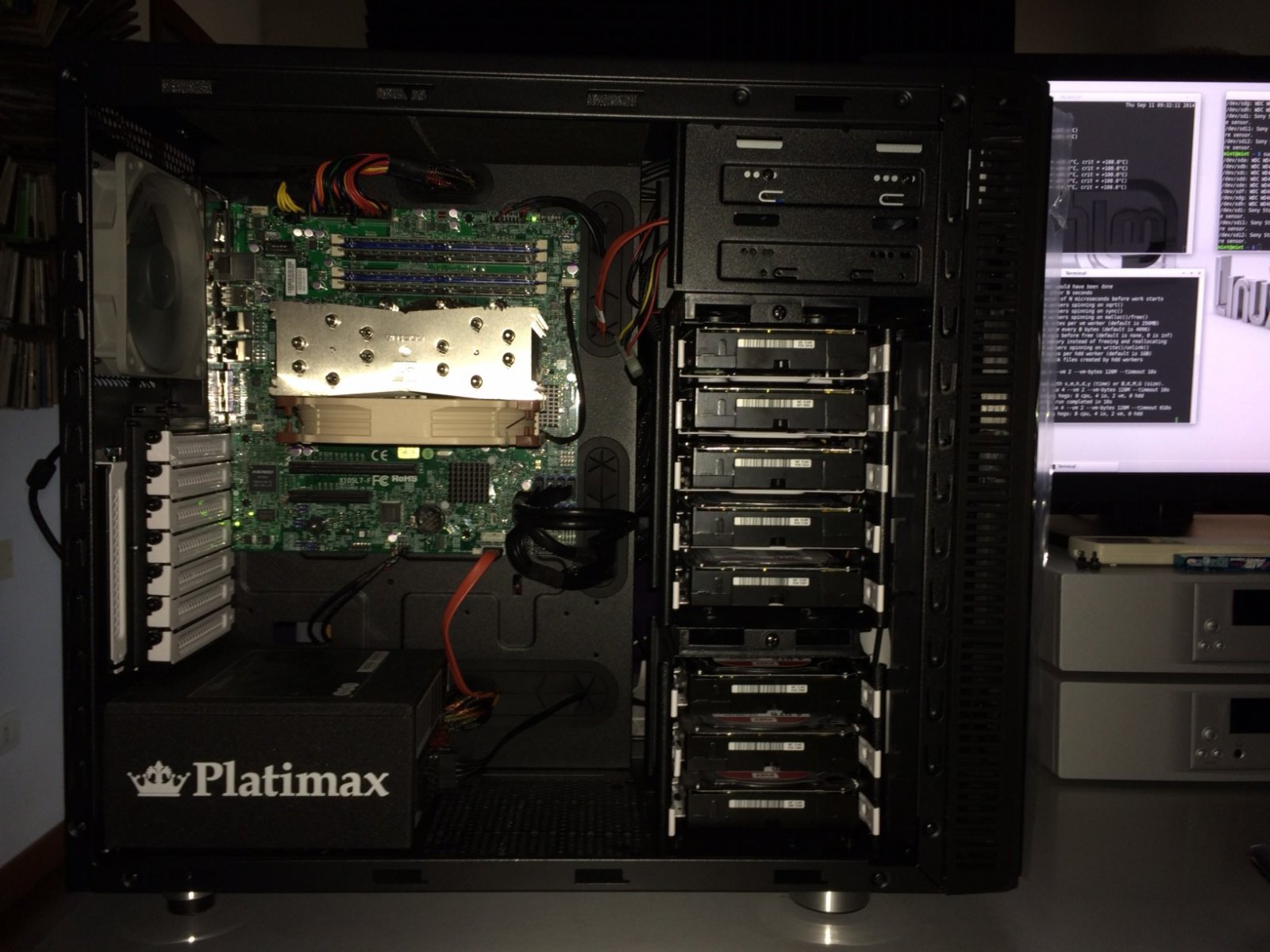

Thanks to this forum my freenas server is on and working great. ups too :)
x10sl7-f
e3 1230 v3
8x wd red 4 tb
Here I'm doing some burn-in test
Reading around here I realized that my data are still not safe. I have about 9 tb of data at the moment, of which more than 4 Tb of flac music files ripped by myself (20,000 cd's) and I'm really afraid of losing almost 10 years of hard work...
So I'm thinking about backing up data to another freenas server
I will use this new machine ONLY for backing up the main one, so I thought about this configuration:
x10slm-f
pentium g3220
8gb (2x4) crucial ecc 1,35
6x wd red 3 Tb
psu corsair rm 650 or cx 430
I have already everything except mother board and ram
Do you think that it's ok for this purpose?
cpu too slow? not enough memory?
I would like to switch on this machine when I want and the backup start automatically.
which is the best way to do that? rsync over ssh or rsync module? Or something else?
Anyone can recommend a link about this?
Thanks in advance
