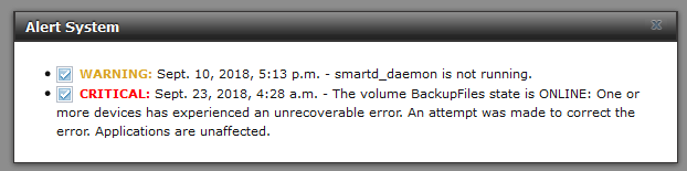

I don't understand this CRITICAL message, and what it means. Can someone explain, and tell me how to fix it? It's been in my Alerts since Sept 23, and it's now Oct 4 and hasn't gone away.
The volume BackupFiles state is ONLINE: One or more devices has experienced an unrecoverable error. An attempt was made to correct the error. Applications are unaffected.

This means exactly what it says on the tin: the volume "BackupFiles" is online, but one or more of the devices in it (your disk drives) has suffered an unrecoverable error. You have enough redundancy that ZFS was able to correct the error, and applications are unaffected.
Investigate your volume status under Storage -> Volumes, select the "BackupFiles" volume, and then click the bottom button labeled "Volume Status". For easier copy-and-pasting to the forum, you can also use a shell or SSH session and issue the command zpool status BackupFiles - please paste the results inside of CODE tags if you do this.
Most likely you have a failing drive, and you should consider replacing it. See the documentation under 8.1.10 Replacing A Failed Drive.
http://doc.freenas.org/11/storage.html#replacing-a-failed-drive
If you have a spare SATA/SAS port, you should consider attaching the additional drive and following the "Replace in-place" steps in 8.1.11 Replacing Drives to Grow a ZFS pool
http://doc.freenas.org/11/storage.html#replacing-drives-to-grow-a-zfs-pool
You also are not running the SMART drive health checks, which will give you early-warning notices of drives that are experiencing difficulty.

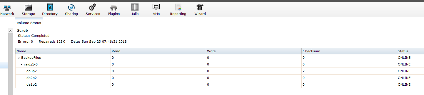

Thanks for the reply.
This is what I have on the volume status page:
As for the SMART health checks not running, the SMART service won't start, I think it has something to do with the drives are on a Dell PERC330 RAID controller and the PERC330 is doing the RAID, not software. Is there a way to fix this?
HoneyBadger
actually does care
Administrator
Feb 6, 2014
5,112
You have two CSUM (checksum) errors on device da3, but you have a far bigger problem:
