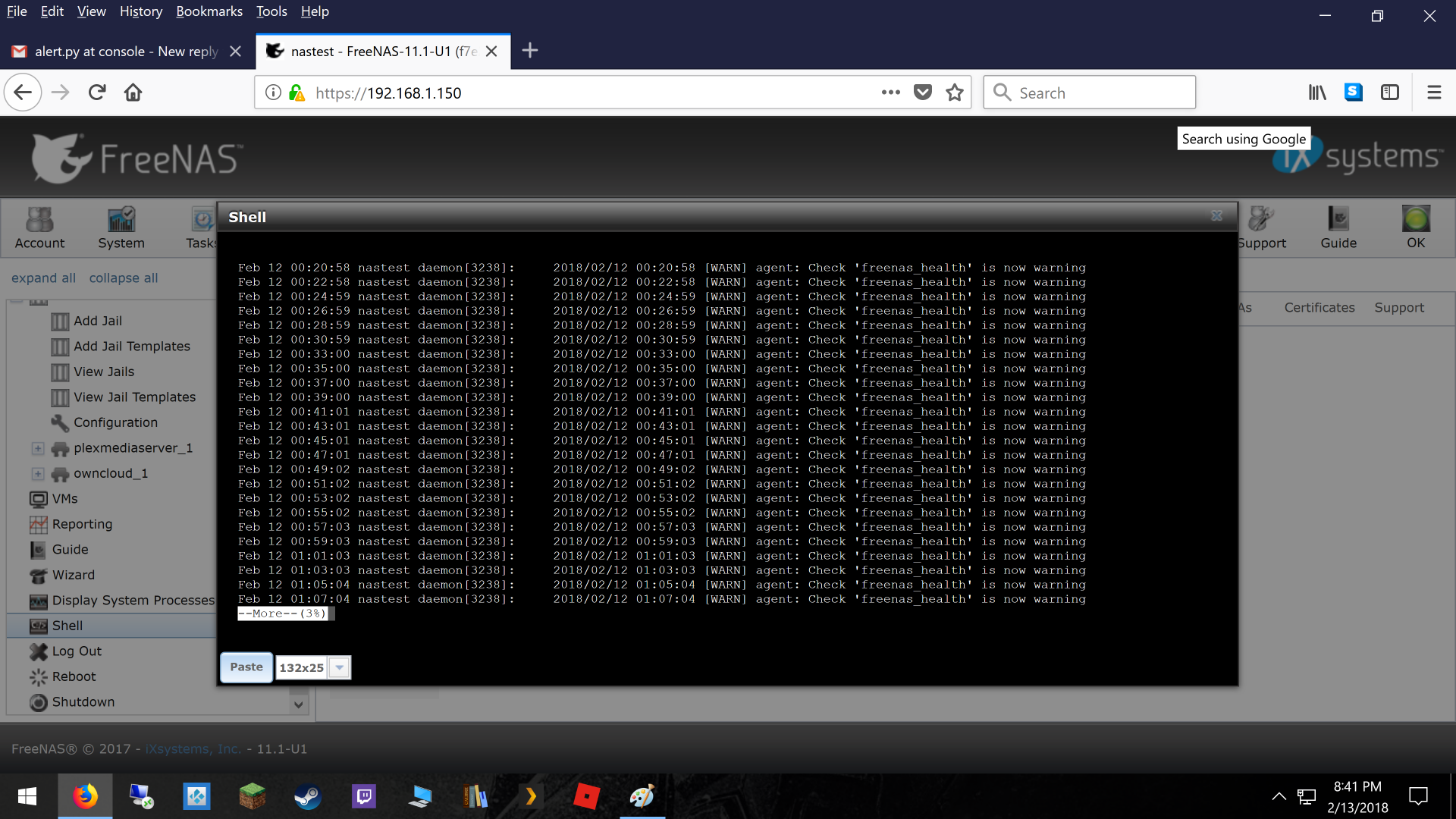

page after page of the attached image....

I think you'd have a message from arp if you had an IP conflict. You might search the logs for "arp:" I think the output would look something like this:
...Arp: 00:00:00:00:00 is using my IP address 192.168.30.254
(Obviously with your IP address(es))

Nevermind. I think what you have is an internal conflict on the Freenas Box.

Per Bug #27298 - try "service middlewared restart" in the Shell and see if the Samba messages stop...
Or, in fact, have they already and all you are seeing is what you showed in the image above (which is the result of a bug that is in the works to be fixed)? In which case, no need to try anything.
