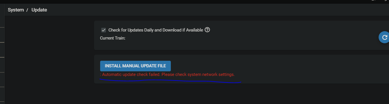

Yesterday I upgraded to latest 12.0 U-1.1, when I click check upgrade again. keep getting this:
my server is able to reach out internet.

I've checked a couple systems here, and it seems to be working. What is curious is that you don't seem to have a train selected there. Can you check with a fresh / private browser window to make sure its not a local browser cache issue?

I tried private window and other machines, but always the same. Before I upgraded from 11.3 U5 to 12.0 U1.1, once I click the "refresh" button, i can see the train. Since upgraded to 12.0 U1.1, every time I click "refresh" button, it shows that message.
is there a way to see some detail info??

@jcnas - Looking at this I'm thinking its an issue with your default Train being missing or mis-configured. Please open a ticket on jira.ixsystems.com and we'll investigate further and see if we can give you a CLI command to reset it as well.

That doesn't seem to be the case; network connectivity is fine. My WebUI is that same as OP: nothing is displayed for "Current train". I have also tried clearing the browser cache.

What does midclt call update.get_trains | jq show? If it doesn't show TrueNAS-12.0-STABLE as the current train, then run midclt call update.set_train TrueNAS-12.0-STABLE.

Looks like a timeout...

Ugh. Looks like your middleware has partially crashed. Try rebooting, and then running the midclt query again.
Samuel Tai
Apr 24, 2020
4,896
No, it looks like you have a corrupt installation.
Samuel Tai
Apr 24, 2020
4,896
What's your install media? If it's a thumb drive, those are no longer recommended since they can silently corrupt and result in all sorts of strange behavior. Current best practice is either a SATA DOM or a small SSD.

It is a thumb drive indeed.

In the meantime I was able to manually update to 12.0-U2 and this seems to have resolved the problem.
