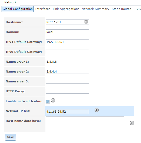

If the answer is no, then the problem is your DNS settings, and you should probably specify a nameserver (e.g., like 8.8.8.8) in the network global config.

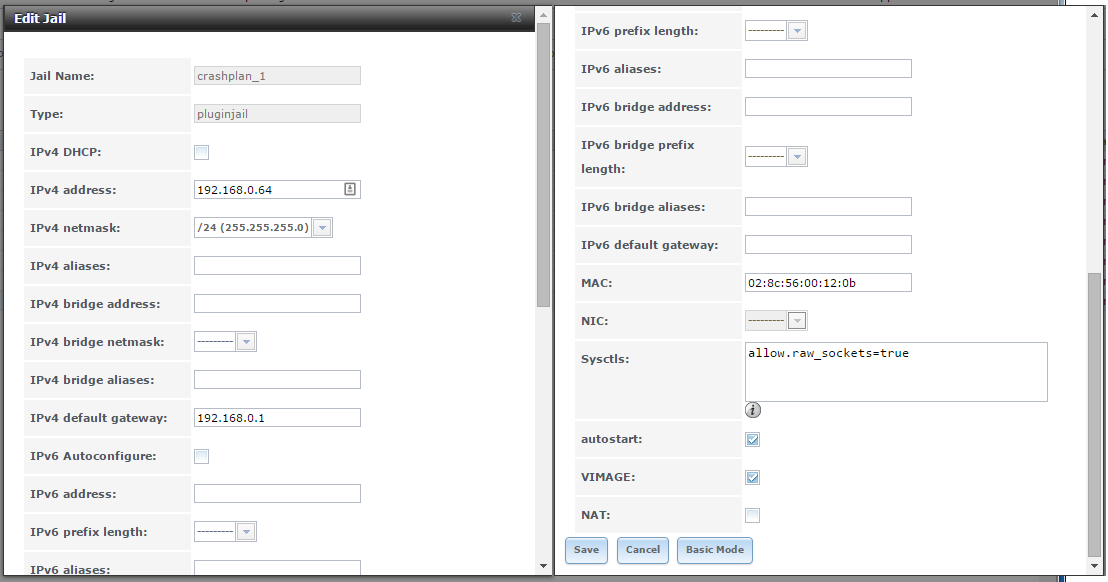

Do your jails have "VIMAGE" checked? Are the jails on a fixed IP, or are their IP address obtained via DHCP?

Jail has VIMAGE checked.
Jail is on a fixed IP.
I've attached screenshots of network global config, and of the jail setup.
