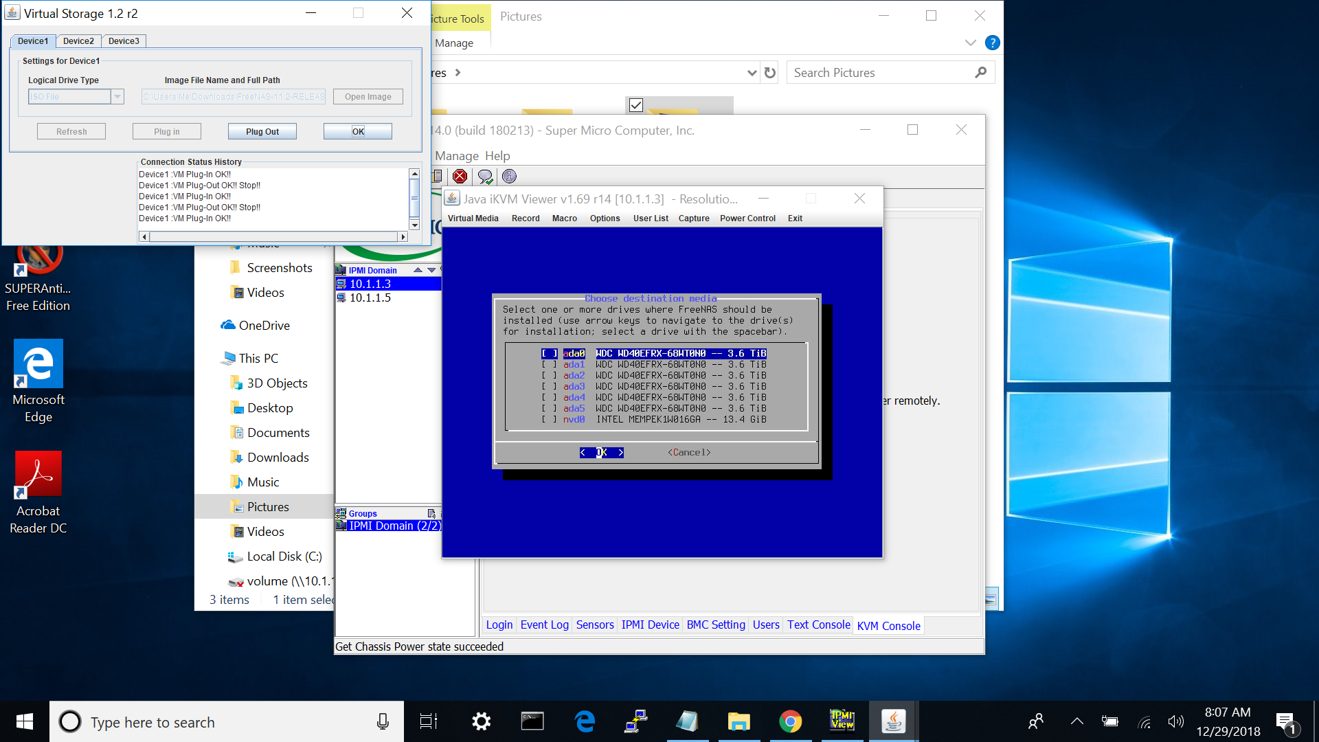

So I installed an m.2 card and installed FreeNAS on the it no problem but after installation, my system will not boot from the m.2 card. My board does not recognize the device at all. Strange cuz the FreeNAS install recognizes it as a drive, but I do not have the option to boot from it afterwards. Any ideas?
First pic is Intel m.2 drive recognized by FreeNAS
Second pic is boot menu with only my NAS disk and no boot drive.

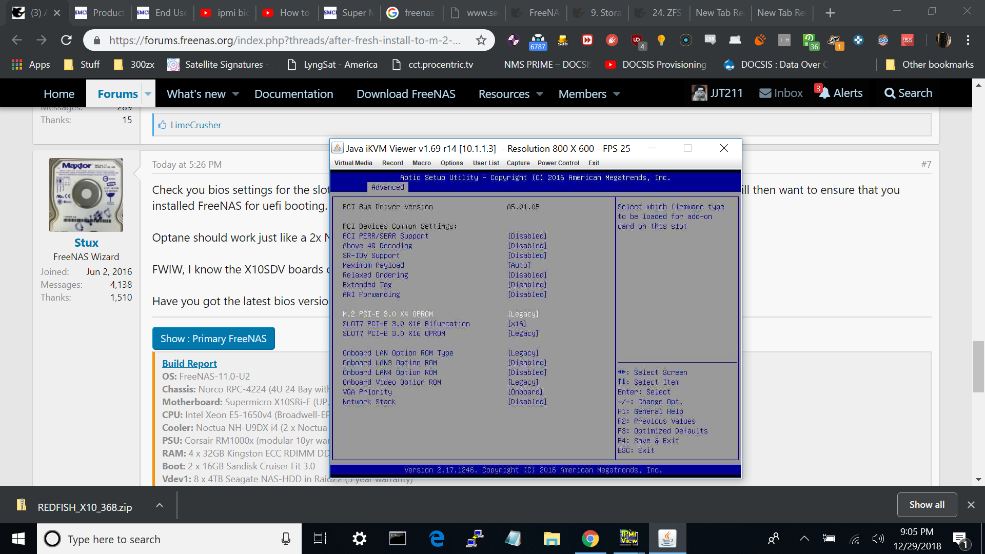

Stux
Jun 2, 2016
4,419
Check you bios settings for the slot (slot 7 iirc) and you may want to be in uefi boot mode not legacy etc. and you will then want to ensure that you installed FreeNAS for uefi booting.
Optane should work just like a 2x NVMe device. The issue I’ve heard about is when using it in a 4x bifurcated slot.
FWIW, I know the X10SDV boards can boot off Samsung evo/pro nvme drives.
Have you got the latest bios version installed?

Cool, think I found it
Which one should I set for EFI? Set the m.2 to EFI, or slot7 to EFI or both??

JJT211
Jul 4, 2014
323
It worked!!!
I set both of those settings to EFI and installed FreeNAS UEFI and bamm, it recognized the m.2 drive.

sremick
Sep 24, 2014
323
It worked!!!
NVMe booting requires the use of UEFI, unfortunately. This isn't unique to FreeNAS.
