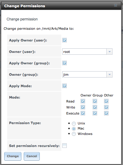

Can you post a screenshot of the NFS settings you used?
Glorious1
Nov 23, 2014
1,194
Here's the NFS share settings, the dataset settings, and the dataset permissions. Thanks for taking a look
cyberjock
Inactive Account
Mar 25, 2012
19,526
You goofed it bro. Read the little tips for the blocks.
Authorized networks: Networks that are authorized to access the NFS share. Specify network numbers of the form 1.2.3.4/xx where xx is the number of bits of netmask.
Authorized IP addresses or hosts: IP addresses or hostsnames that are authorized to access the NFS share.
NOTE: You entered a non-hostname or IP address in the block.
I bet if you fix it you'll see it work properly. ;)

Glorious1
Nov 23, 2014
1,194
Hmm, one thing leads to another. In the dataset permissions, if I turn off privileges to "Other", the NFS client can't see it. If I turn them on, anyyone can see it in AFP. Is there a way to make it available for reading in NFS, but not in AFP (except to owner and group)?
Edit: I did it by entering myself and my group into the AFP share's 'Allow List'. Then I can leave permissions on for Other. Seems like a bit of a workaround, but this is an unusual setup I guess, and it works.
