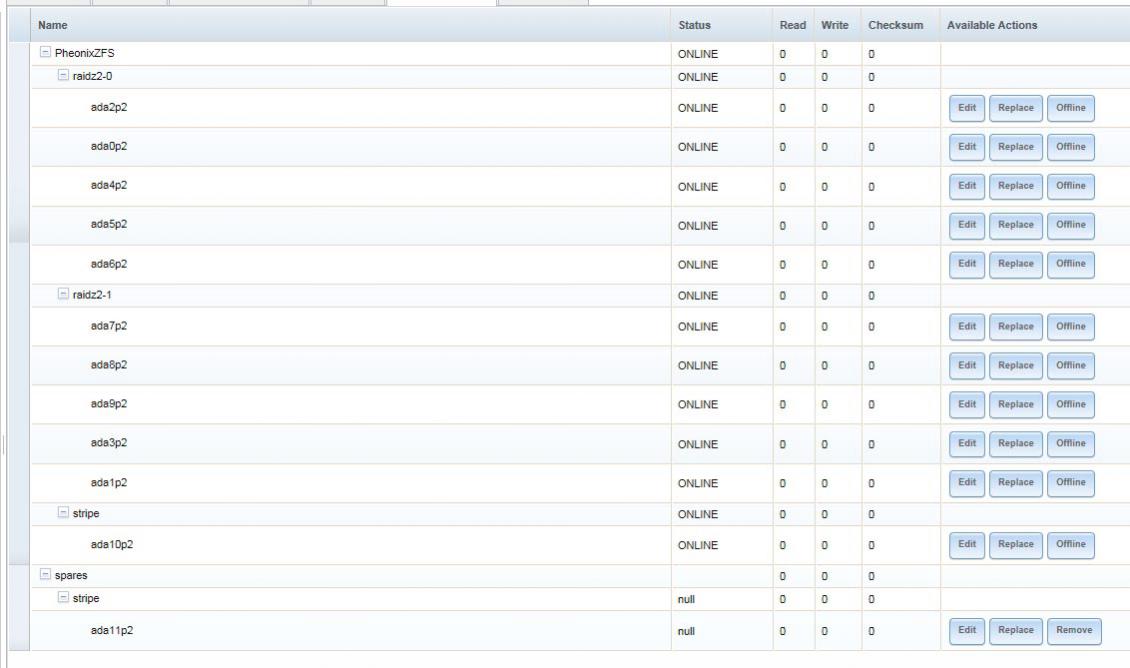

I am trying to add two spare drives. I had posted about it, but was trying to figure it out while waiting for an answer. I think I caused more harm than good. (I replaced the old post with this one)
I was trying to add one drive at a time and somehow ended up adding a (live?) drive to the pool.
I try to take ada10p2 off line and get the following:
"cannot offline ada10p2.nop: no valid replicas"
How can I get this out of my pool?
Thank you in advance

I had originally had that setup, but I was concerned that it was stripe, so I was playing around trying to add one spare at a time. (I have deleted that picture from the post above.)
The attachment shows my current configuration, and it looks like I accidently moved one from spare to being in the pool. My storage capacity is about 2T higher than it was before. I try to take the drive offline and get the error:
Thank you.

I understand that it was wrong (I have have read the guide a couple times), the question I have is there a way to undo it without starting over. I have not written any new data to the device since I did it, can I somehow remove the disk I accidently added?
bollar
Oct 28, 2012
411
Ah, I see the attachment. No, there's no way to undo that that I know of.
BTW, the one thing you could do to restore redundancy is to mirror ada10p2 with an additional drive. This may create performance issues, but it'll at least protect the array until you're ready to rebuild the zpool.

There's no way to "undo" it. :( That's specifically why I mention it in my guide. It's a one way ticket to single-point-of-failure.
Edit: Someone recently added a single drive, then before he added any data to the server he shutdown the server, pulled the "stiped" drive and zeroed it. Now he's on page 3 of trying things that aren't likely to work(and he's trying the last option now). He had no backups. I tried to find the thread but I couldn't find it easily.
